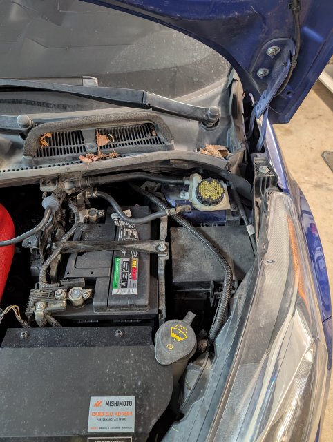

2014 with 97.5k miles, bone stock engine.
This click click start thing is happening with increasing frequency, probably every 3 starts now. You can see the lights dim each time it clicks. It always starts eventually.
The battery is about 4 months old. I also swapped out the starter relay in the fuse box with no change.
Anyone else experience something similar? Sounds like some folks have had it click and not start but I didn't see any clicking then starting. I guess the battery could be bad or not fully charging but I'm worried it's the starter.
