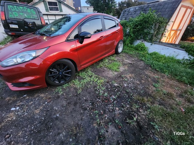

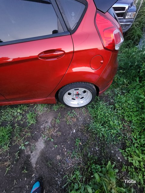

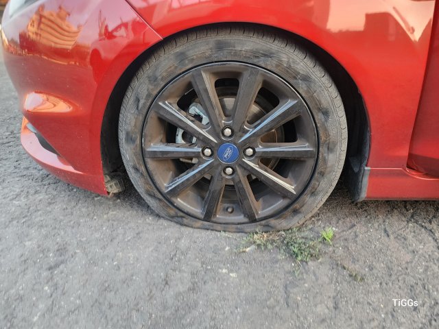

Ran into a slight setback. Dang low profile tires and potholes. I have a bunch of Honda and AE86 rims, but none bolted up. I assumed one would. Had to put on some universal Welds I had sitting around for the time being.

The bubble lense on that camera makes it look even sillier LoL. Just need the BIG'OL fart-can exhaust to go with it. πŸ˜‰ Buy hey, you do what you have to. Good use of the available resources. πŸ‘
What brand of tire blew-out? Some are much more susceptible than others. The stock Bridgestone on the ST were pretty resilient. But the suspension was also engineered around a hard low-profile tire.
Nexens. It was a serious pothole. Entire rim went in. Used to driving my truck with big ol side walls.
They are rediculous but better than a donut. 8" wide with 0 offset. Until I can get adapters/centric rings for my other rims.
Interesting note about the suspension needing low profile tires. I was thinking of going down a rim size to get more sidewall.
