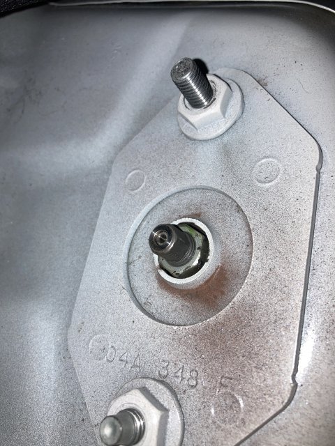

I'm having this same issue after installing Bilstein coilovers. When I got my wheels aligned and balanced, they said I should look at the shocks to see if something is rubbing and that it isn't the springs. He suspected that it's the rubber where the shocks touch the body.
The holes that are being referred to in this thread, are we just talking about where the shocks get installed and the bolts are tightened? The holes that would be opened up is where the shock goes through, not the holes where the bolt goes, correct? Previous coilovers didn't have this issue so I'm wondering what gives.
Now to find a way to open up those holes, if they are the issue...
#20328
23
5
#19
I took a picture. I think this is where the squeaking is coming from. On the passenger side, rear, the nut seems to be touching. The driver's side touches too, but just ever so slightly.
I'm assuming this is the hole people are drilling into? Could I just get a thinner nut? Anyone know what size nut that would be?
#17286
8
#20
Yes, I can confirm it’s the top bolts rubbing against the body! Ugh, did ST not test fit these before sending them out? IMG_2100.jpeg
