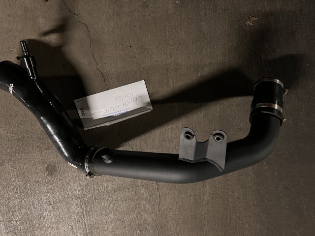

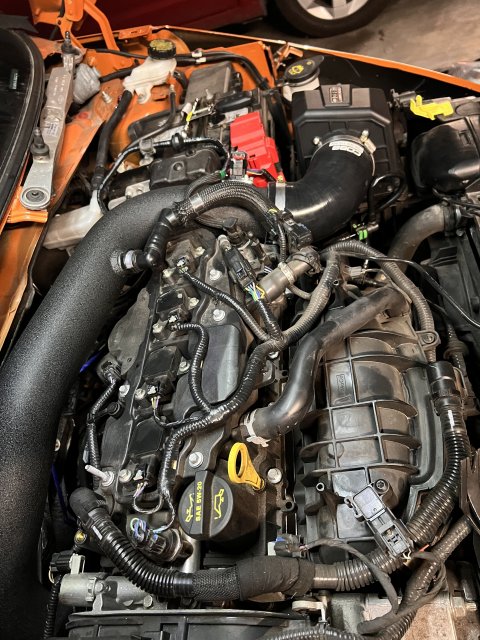

Out with the old in with the New removed my Mountune Hose with Whoosh crossover pipe 2.75 for a full 3 inch COBB Carb legal intake . It attached to the ST200 bottom So I have a larger filter along with true cold air.
Bottom pic is old setup Whoosh. crossoverpipe and Mountune Hose which is a Great setup as well.

That looks really good. Any more noise from the Cobb? I have basically the exact same setup as your previous one and keep eyeballing the Cobb too

I have only driven it to the grocery store and back because Playoffs .:LOL: Though I will be going over to my friends house for the 49rs Rams game . North Vs South. I did notice its spooling a bit quicker and has added a bit more grunt to the exhaust note if that makes any sense. I will give more impressions after the games.

Ya its a sweet setup and it probably helps my car because of the s280 .
Though I will say this when Jason aka Dizzy did a test of intakes he found that the Ramair/ Whoosh crossover pipes showed actual dyno tested improvement.
I would say it might actually give you some improvements as the Whoosh pipe is 2.75 inches and this is 3 inches.
It would be an improvement over someone just running a ST200 box with stock piping.The Whoosh is an improvement and not as expensive because it’s not a full setup. Though it’s a great start if you don’t want to buy the whole setup.

Are you running a "14-15" evap harness with that? Also what type of turbo elbow comes off the S280? When i have my hybrid installed I may have to choose between airtec elbow with takeda or older whoosh elbow and can then use my Cobb. Interested to see how you like the Cobb.

I am using the setup Cobb provided with the new intake for my year. All I had to do was remove my single line from the cold side pipe that went up to my intake previously and put their hose on it came with the clip on.
the S280 has a 2.75 outlet and elbow hose with a metal reducer to 2.5 . I for a minute and using that with the 3 inch to 2.5 hose the Cobb came with but I have a 3 inch hose and I am looking for a 3 inch to 2.75 aluminum reducer . I bought a 3 inch hose and 3 inch adapter thinking the S280 had a 3 inch outlet and elbow it did not. :LOL:
