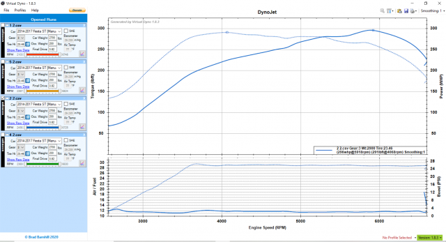

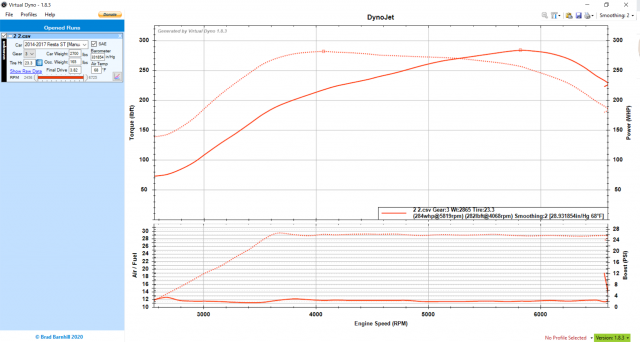

and a few adjustments I have been focusing on the curves and the fact that shouldbeasy did not have to add much smooth at all . I am putting out 284 HP according to Vydno on 91! This chart speaks heaps and bounds about Adam’s Tuning. Fact is this is the the 2nd revision from a base tune! Tuneplus FTW.

Quick question: are you logging in 3rd or 4th gear? I'm hoping to not need to use 4th honestly lol
#7958
6,361
5,983
Thread Starter #86
These are 3rd gear logs. I did have to wait till I had a reasonable temp though as one it got down into the 50’s I was getting a lot of tirespin but thats partly because I am running Rs Pro’s.
MagnetiseST
#7855
1,318
1,166
#87
Good stuff. Im logging my roommates car for his S280 tune from Tune+ as well. I was tuned by CPE on mine, and I have to say that Adams tune is leagues ahead of CPE, second revision already blowing the doors off the car and feels better than my completed tune did. Its crazy how much more Adam is doing than anyone else.

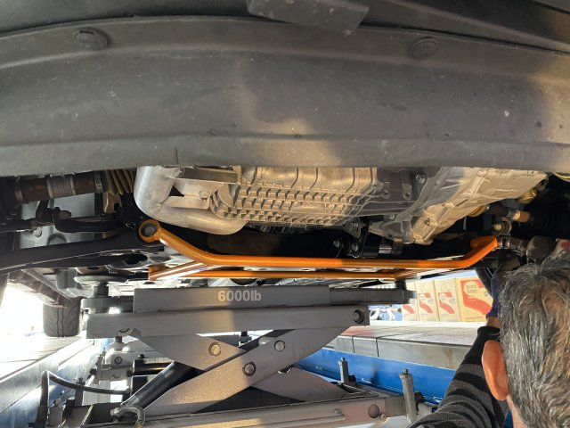

Look at what arrived today! Swave Summit 4 point forged Aluminum triple tube brace. I I guess I know what I am doing tomorrow afternoon. lol
maybe I'm splitting hairs but really curious if there's a difference in height clearance between this and the TB 4pt traction brace. just got on the TB brace thrown on (purchased in Nov when it was not known if and when Ron would get the Summit braces) and not sure if it would make sense to compare since we're more local.

And Summit Brace in! I just drove her around and even with the S280 TQ steer is now minimal to nonexistent.
Also the front end just feels solid now and totally tight on turn in.
I should add clearance is great.
This brace is dope!Thanks again Ron@Whoosh Motorsports BCBFBAF4-AE1A-45F8-823C-03B739BEAAB7.jpeg for bringing this in.

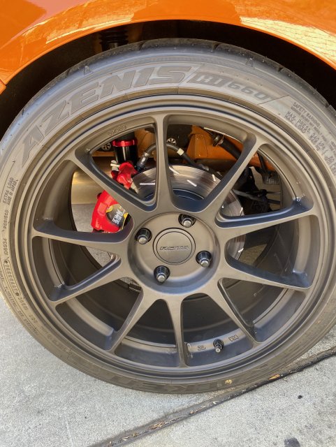

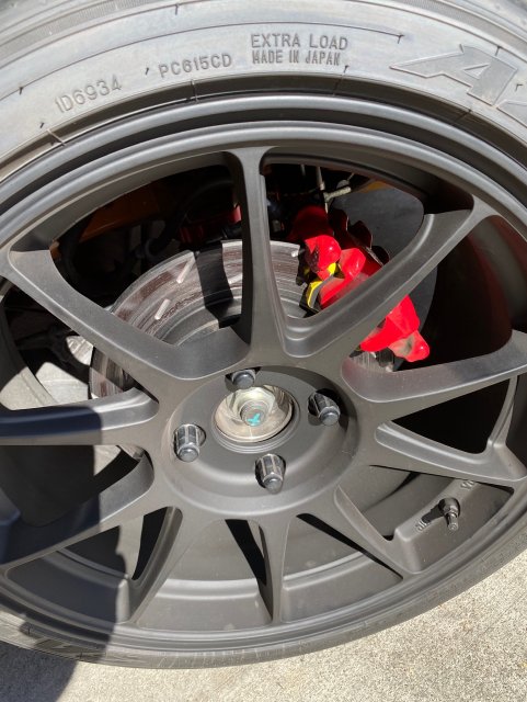

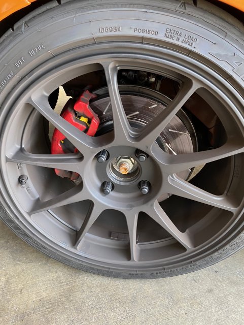

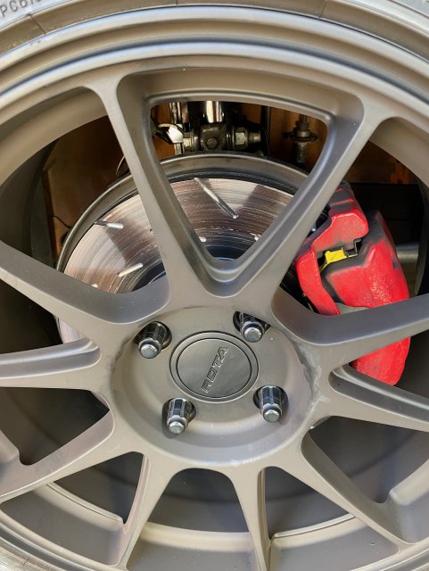

Hmm what have we here Some EBC Brakes aka pads and slotted rotors! Todays game is guess the Suspension. hmm maybe you will get a discount on some Camber plates? 2CB4A82C-0BBE-4880-898E-8F4BD4D5D336.jpeg 54EB7135-3C2F-46C2-87EB-1ED42813020E.jpeg D1E5CAAA-B9EF-4BD4-BD14-16C56A663560.jpeg 3936BFFB-C22B-4DD1-8436-CAF7CBBD85E9.jpeg and different Suspension!
#7958
6,361
5,983
Thread Starter #96
Meister R? What spring rates did you go with?
Bingo ya It was kinda of a giveaway in the pic if you know the colors lol. I went with 5/3 I also added a bit more camber to the front and my tires clear no problem now. Though I have not really taken it out yet to bed in the brakes. That will happen this weekend I think I will be making more ride height adjustments on Monday gonna drive it around this weekend and let stuff settle in a bit.

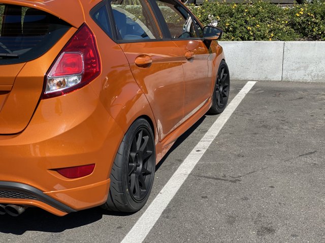

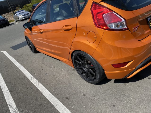

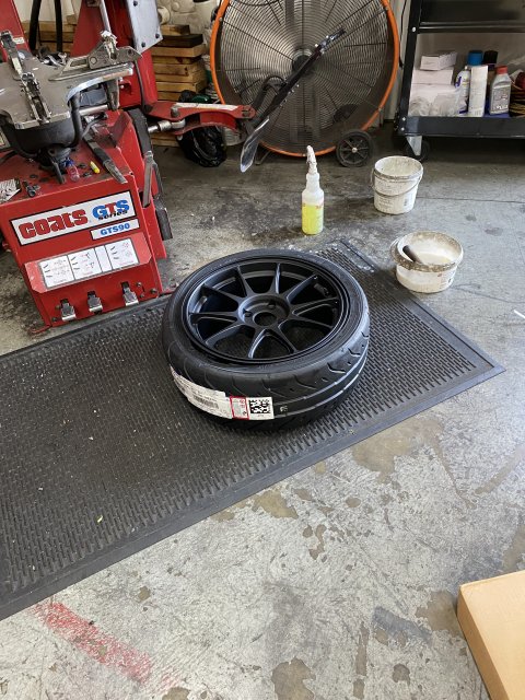

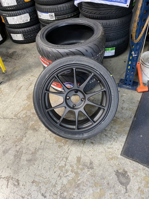

Oh look I get bored with wheels :LOL: So its new shoes and socks time,
Keeping my Dekagrams but adding these into the mix . Titans! 17x8 215/45 uber sticky Falken RT660’s! View attachment 39304 View attachment 39305 View attachment 39306 View attachment 39307 View attachment 39308 View attachment 39310
So why the size change? What’s the performance advantage? Better turn in? More tire options? Curious people want to know. By the way, I thought the Titans were 17x7.5? Does this tire/wheel setup fit better underneath as far as fender rub or lack of? Thanks
#7958
6,361
5,983
Thread Starter #98
It was mainly because I wanted to see difference in turn in and I like the look of the Titans a lot:ROFLMAO: . They have some concave to them which I really like. They also were light enough for a 17 at 17.4 pounds each to warrant getting them, I then shoe’d them with RT660 tires which are stickier and quieter than the RS Pro’s .
I still like the RS Pro’s cost wise . Though I absolutely love the RT660’s tires wise. I did not sell my Dekagrams, they are stashed away I could toss them on at anytime. I was also considering putting a set of RT660’s on them. .
