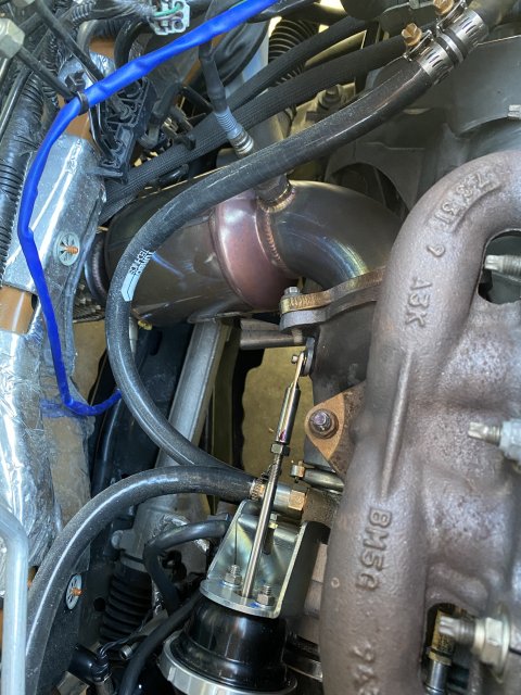

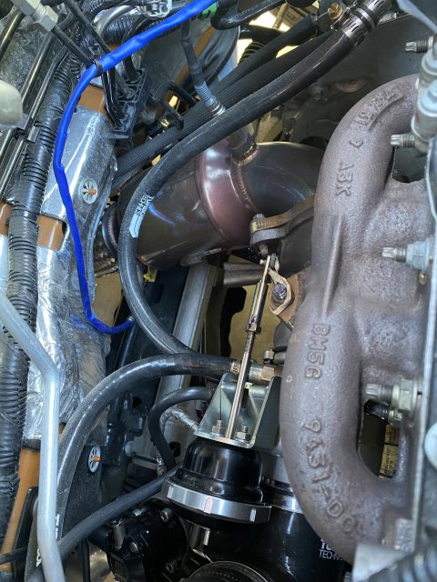

So while I do not have pics of actual Turbo and down pipe install I do have some pics of my fun adjust wastegate actuator on the car. :ROFLMAO: I figured I would post these in part because no one ever talks about it and it can happen.
So long story short getting new tune from Adam at Tune+ had an Antspec Tune previous done on their dyno. They had adjusted my wastegate actuator and on Adams base map I was only seeing 13lbs max . Adam stated I need to adjust the Preload so I saw at least 14lbs. for his Base map.

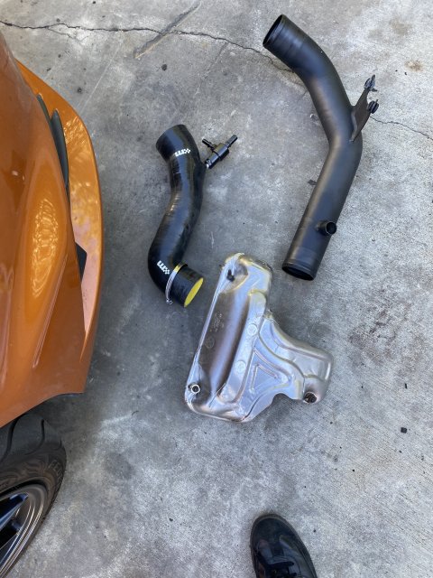

So here are a few pics , Basically its not hard to do its pretty straight forward . Remove windshield wipers remove headlight, remove upper and lower cowl. Take off your crossover pipe and remover upper heat shield on exhaust manifold and boom there is your wastegate. 7C339D56-FD85-4D10-BFAB-12EE2084DC97.jpeg
of course all the fun stuff removed minus the more mundane aka cowls wipers and headlights. Which leads us to the fun part 423FD3D8-FEB0-434F-82BB-7C14FE0948FB.jpeg
notice I marked a location for turn sets on the preload and also attached a rubber to keep the wastegate door from falling down towards my downpipe. We then used compressed air on the wastegate nipple to push the rod back out after I did my adjust which in my case was 2 1/2 turns Adam recommends 3 and a half out of the box. I am guessing Ant Spec had it at 1 and 1/2. Interestingly enough Ant Spec had me tuned at up to 25 psi max. I will not go further into the details between the different approach the two tuners take other than to say Adam has a lot more experience tuning S280’s.

After adjusting the rod we then tightened the nut and clipped the rubber band. Put everything back together and now my Pre load is properly set to start doing datalogs for Tune+’s S280 unlimited package . I will be getting tunes for 91 , 93 which can be achieved here with pump gas and 2 gallons of race gas and E30.

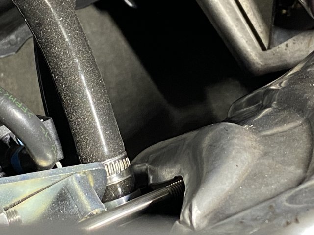

if we are talking about the upper yes. There is one bolt on the towards the front that is nearly impossible to put in but the rest go on fine. Below you will see a pic of the Wastegate Actuator rod just clearing the heat shield. Now getting the lower heatshield to fit on the Mountune Sportcat HHMMM lol. D1B43F5D-CF62-4A2D-B970-20334413CAA8.jpeg

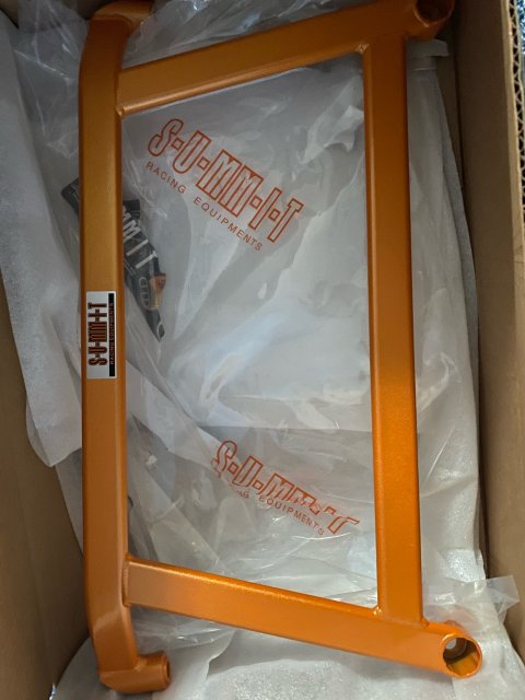

Its triple forged Tube aluminum, I have been following these Braces for the last couple of years and was going to order one from the UK because that was the only way you could get them Until..... Ron stepped in and took on the Swave Summit line.
Yeah I know what it is made of, but Ron won't answer what the wall thickness is...just wondered if there was anything the documentation you got (if there was any).

I would not be too worried if I were you. I am pretty picky about my parts. Plus they have been selling these in the UK for years. No one has said anything bad about them., I like the fact that its light, strong and has a low profile.

they are nice and wish they weren't so pricey. I imagine it's over 2k with all the bracing. still will most likely splurge for the 6pt tunnel brace not listed on Ron's site just yet, the UK2B brace I think it is.
