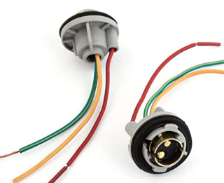

1) Purchase the 3-wire 1157 socket.
https://www.amazon.com/uxcell-BAY15D-Signal-Harness-Connector/dp/B00LGKE4XM/

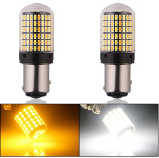

2) Purchase an 1157 white/amber switchback LEDs.
https://www.amazon.com/dp/B085ZRQ43M
3) Put your new LED into the new socket and test using a 12v battery source.

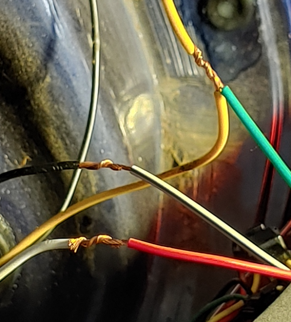

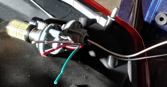

5) At the OLD socket, cut off the black (ground) wire. Cut off the white (12v) wire.
Photos:
Just three simple connections. (solder then wrap)
IMPORTANT: These particular LEDs flash 'amber-off-amber-off' instead of 'amber-white-amber-white' -- This means no reverse lights when hazards are activated. Feel free to post alternative LEDs that allow reverse with turn lights.
* Red wire = White light
* Green wire = Yellow light
* White/Black wire = Ground
* but could be different if receive different sockets or/and LEDs from the above.

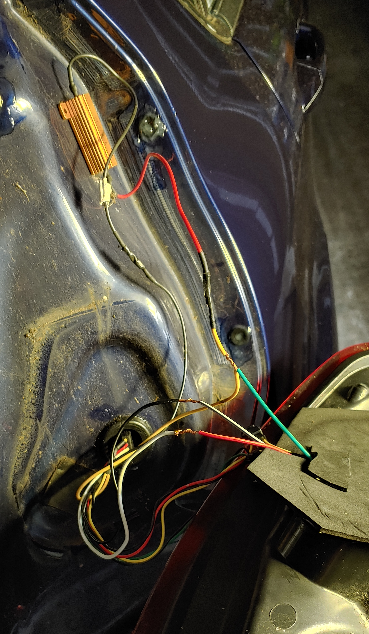

4) Twist-out old socket, twist-in your NEW socket into the Spec-D housing.5) At the OLD socket, cut off the black (ground) wire. Cut off the white (12v) wire.
* Connect NEW socket White/Black wire --to-- Spec-D Black wire. (Ground)
* Connect NEW socket Red wire --to-- Spec-D White wire. (Reverse)
* Connect NEW socket Green wire --to-- Spec-D Yellow wire. (TurnSig)

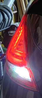

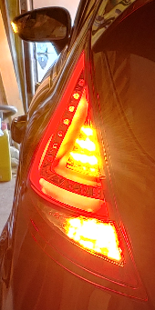

6) Protect your connections against accidental shorting then activate ignition (no need to start engine) and test:* Hazard Lights,
* Left TurnSig, (no hyper-flash)
* Right TurnSig, (no hyper-flash)
* Reverse Lights (leave reverse engaged and re-check hazard, left turnsig, right turnsig)
Photos:
