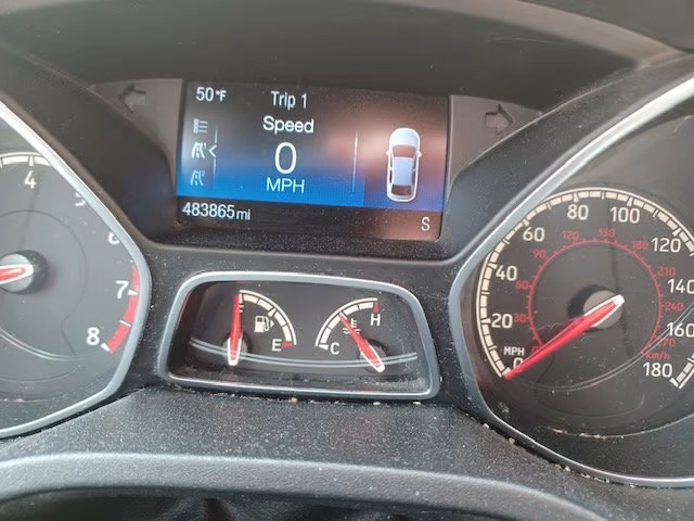

Have you tried using a short length of silicon rubber hose? Cannot remember what ID I use but it fits tightly on the porcelain insulator. That is what I use to remove the plugs on my '15 Focus ST after loosening them with a socket wrench of course. (480,000 miles-has had MANY changes) Have not done one on my '19 FiST (25,000 miles) as of yet.

You have a Focus ST with 480k miles? Going to need more details on that.

A whole lot of courier driving plus Uber service as well-stopped courier work last year so miles are a bit slower in accumulating.
Wow, that's the most miles I've ever seen on an ST. Are you still on the stock engine and transmission?
All stock, no major driveline work done, original clutch only a water pump, some stab links, 2 evap valves (surprise!) and of course brakes and tires. Struts and shocks being replaced soon. Damn reliable machine.
Original clutch!?!?
Wow, that's very impressive! I'm glad it's lasted so long. Hopefully the fiestas will prove to be equally reliable long term.
