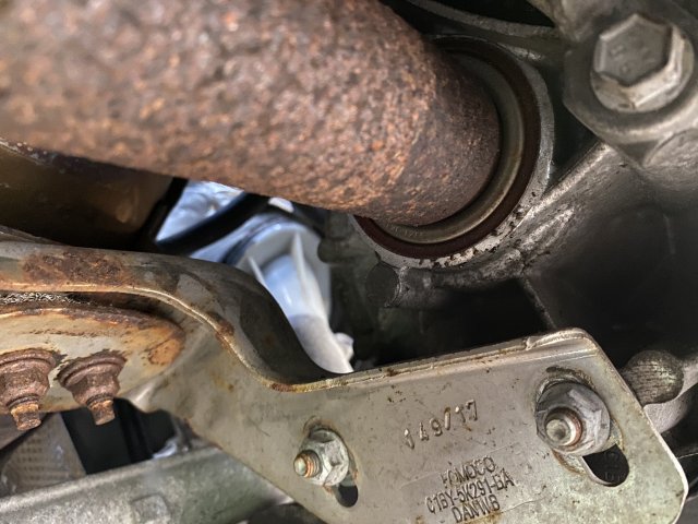

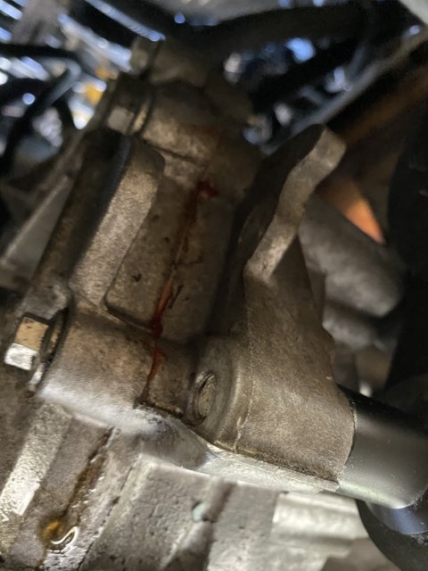

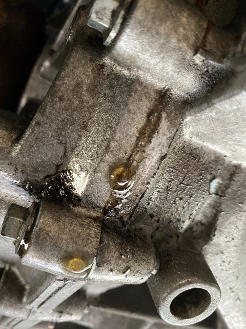

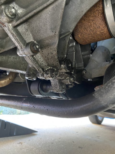

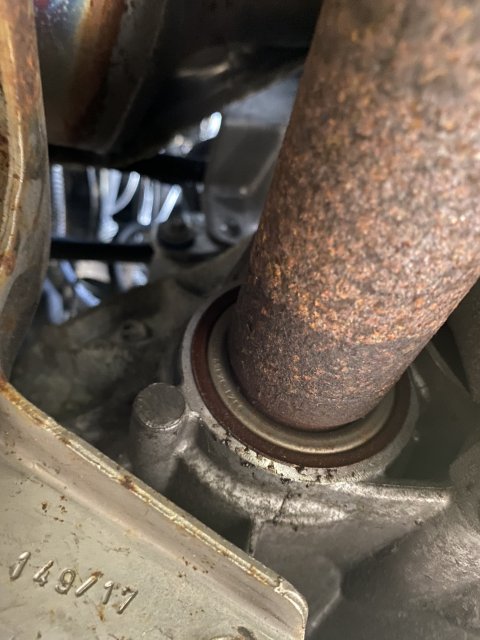

As shown in the pictures, my 2017 (with about 7k miles) has developed a slow leak from the transmission. I can't tell if its coming from the axel seals or the transmission case itself. I had a shop install an LSD about 10 months ago. I also swapped the fluid to Ravenol MTF-3. I hadn't noticed anything leaking until just recently (after my last track day at Blackhawk Farms).
Any thoughts on the cause/source of the leak?
Should I completely uninstall the AP before I go to the dealership, or just flash to the "stock" tune? I assume they'll see the Cobb RMM and Pierce 2pt brace, so they'll know there are some modifications--should I mention the LSD or put the OEM fluid back in before I take it to the dealership?
Thanks in advance for any advice.

That looks like the case is leaking. Good luck at trying to get the dealer to cover it. Id be going back to the installer of the LSD.

Yeah, looks like the case is leaking to me. Go buy a can of brake clean and clean the affected areas. Drive it a short distance to verify where the leak is coming from.
It also looks like the axle seal is weeping but not leaking yet.

Thank you both.
I’ll clean it up and see what I can figure out.
I do think the installer of the LSD should fix it—but given that it’s been 9 or 10 months, I bet they’ll claim it’s beyond their warranty period. I guess we’ll see.

To close the loop on this...after cleaning and inspection, the leak was actually coming from the drain plug. Apparently the crush washer on the drain plug wasn't sealing completely. Replaced the crush washer and all seems fine. (I hadn't lost much fluid.) I'll continue to monitor it, but it didn't leak at all in the last 24 hours.
Thanks again for the suggestions. Glad I didn't take it to the dealership--I have a feeling they would have somehow found something major needed to be fixed.
