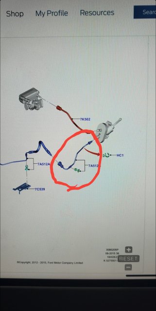

I'm having the exact same issue after replacing the master cylinder myself and the tip of the line looks the same. How did you fix this? Did you have to get a whole new line, or just replace that tip?
EDIT: For anyone reading this later, looks like the part needed is 7A512B: See on Ford.com
I ordered the new line. It was on backorder when I had the issue. Ordered it from 3 different places so I have a few extra. If you are in nc I got you. Screenshot_20210322-103843_Gallery.jpg

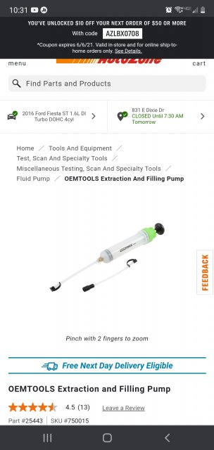

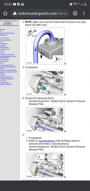

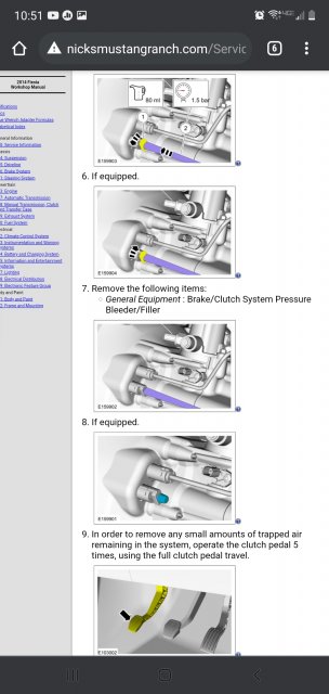

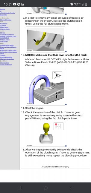

I didn't mess with the brakes but my resovor didn't get low enough to effect brakes. I'd use the reverse bleed method. I did it one time and my pedal is perfect. All you need to do is pump brake fluid in thru the slave cylinder. Remove most of the fluid from the reservoir. Open the slave all the way up and connect hose from pump or bottle and fill up the reservoir nice and slow. I used this pump but a 20 oz bottle with a hose running thru the lid will work.
