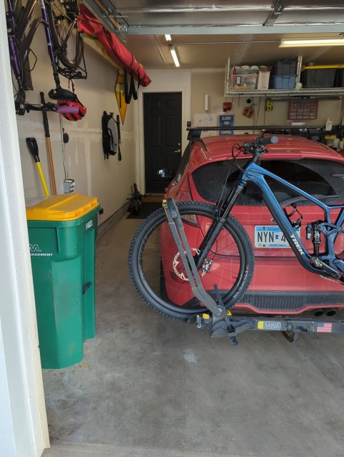

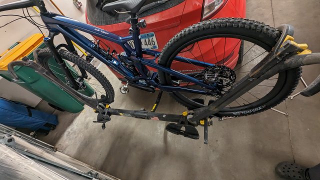

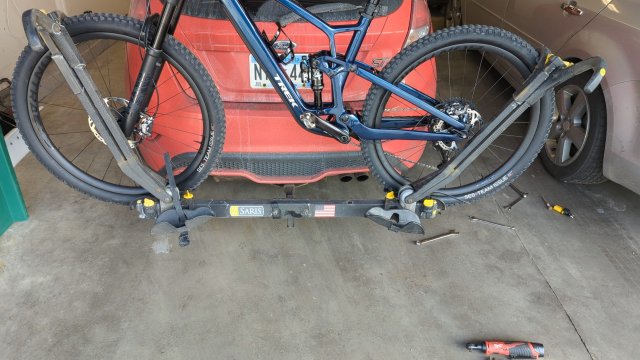

I have a Saris Freedom Superclamp (an original one before they folded up) that I just put the longer beam on for my new bike. Since the wheelbase is 4 in longer than my older bikes. It's crazy how long trail bikes have gotten.
It's light, easy to setup, fast to throw bikes on, and quick to install.
My car is on Swift springs and B8 dampers, so about 1in lower than stock. I have very little issues with dragging on anything other than steep driveways if I don't turn 45 deg when meeting the road.
Sorry for the weird pics, I was fitting the bike in the garage before I got the longer beam for the rack.
Good luck with your setup! IMG_20230218_125616_03.jpg IMG_20230218_125616_02.jpg IMG_20230218_125616_01.jpg PXL_20230218_185239034.jpg

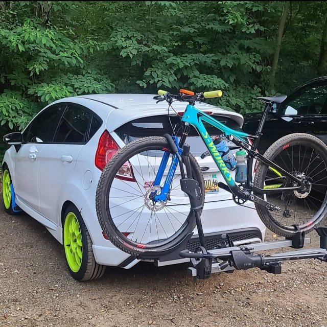

Love seeing fellow MTB'rs who drive the Fiesta. I have the Curt Manufacturing 1 1/4" Trailer Hitch and paired it with a 1Up USA Quick Rack single. My bike has changed a bit since taking that photo. I need to get an updated one. I did install Cobb exhaust hangers to prevent the exhaust from moving around a bit. I also cut a section of the heat shield just to be safe.
Being able to use a hitch was one of the reasons why I chose the Fiesta. I was getting so tired of having to take the front wheel off the bike and either shoving it in the trunk of my old Honda Accord or using the Sea Sucker roof mount. So much better

I don't know that the "frame" of the car is stiff enough to put a class III 2" hitch on it. I have the setup seen above with the molten orange car and the blue Trek (1.25" Curt hitch).
With a single bike there is very little "wobble" however when you add a second bike it does increase, and the rack more noticeably bounces when going down the freeway due to both wind and cracks/bumps in the road which can lead to a resonant bounce if it all is timed just right where the car will have a noticeable bounce for a short duration until it is deadened, often by speeding up/slowing down slightly.
I really don't think that a 4 bike rack work well on the car due to the low ride height and lack of rigidity (I don't think that's what you are looking for however, but I don't see it mentioned, usually 4 bike racks use a 2" hitch)
