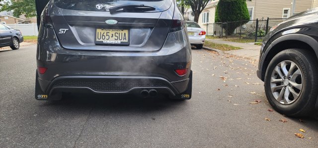

Been seeing a lot of videos recently of blown turbos with decent amount of exhaust coming out of the tips. Changed my exhaust hiflow turbo back. Could just be the first cold day (north east) but here's what I'm looking at.

So with a combustion process water is formed. On a cold day from a exhaust it would look like the picture shown. Don't worry, enjoy your car.

if this is on cold start. That's most likely condensation. Especially if you just replaced the exhaust. I wouldn't be concerned unless your exhaust is still smoking after like a 30-40 min drive
