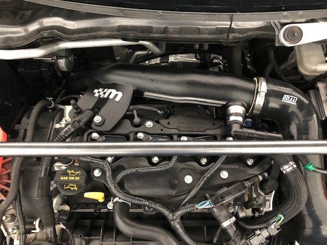

Another pic. It does seem to spool a bit harder, with a deeper rumble off idle.

The mountune is a cast piece, nice and fat, but it does have some indentations to clear some pieces of the engine, so it's not perfectly round. Definitely kicks up the spool though.
