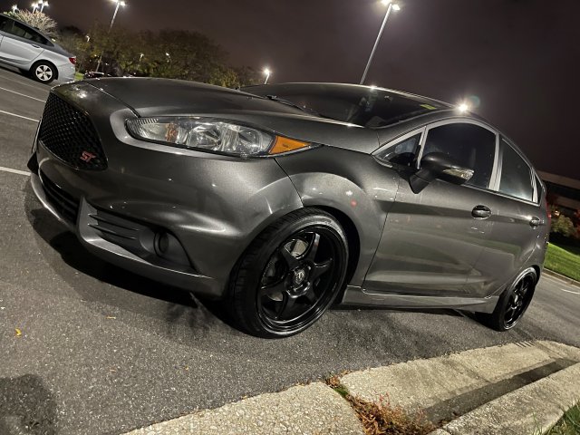

Good day folks,
Hope yall are well.
I'm finally back into a 2017 Fiesta ST Mag Grey (Mileage is about 43k) after a couple years away from my 2016 Fiesta ST.
I wanted to know what's a safe power level for the platform? I'm looking to do simple bolt ons for now and later on get a COBB AP possibly.
I'd like to get the most hp I can get without swapping out the turbo or a major component that would need extensive time/tools. Would 250hp be safe? What mods would I need to get there?
Any advice would be appreciated. Stay Blessed.
