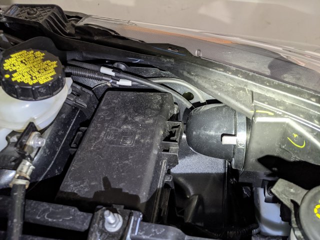

Put on my Techmax GEN1s today. They went in pretty easily. We get so much road salt and gross weather here that I didn't wanna go dustcapless, so I snagged the 85mm ones in the OP and was able to make em work. They do not fit as they arrive, but once the inner lip is trimmed off with scissors they fit snugly and leave a nice huge some behind the bulbs for the fans to make use of.
It's daytime but, so far looking at them in my garage, they don't seem to need to be re-aimed. They're in-line with where my MINI's LED projectors hit, which is probably higher than most, so I may bump em down a touch once I've got a good chance in the dark.

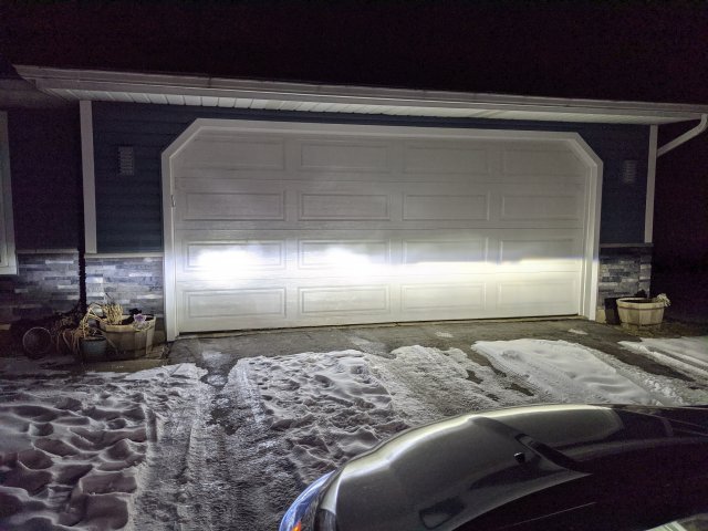

I lined it up beside my wife's Golf R (which has a comparatively low cutoff) and they did look a touch high.
I opted to split the difference and things seem like a fair compromise.
I stood out front and confirmed, visually, that it really doesn't glare until my eyes were below the cutoff.
The difference really cannot be understated. It is a massive upgrade over the awful halogens. That Golf has decent LEDs (good, not great) and the reflectors with Techmax bulbs really fare well, when comparing them on a drive through a part of our town with no street lights.

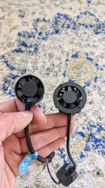

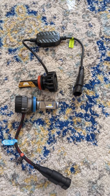

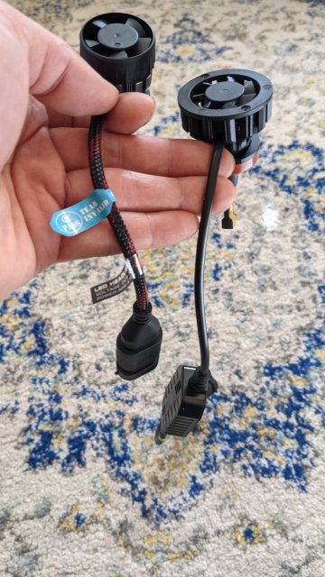

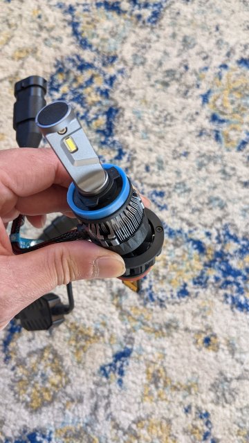

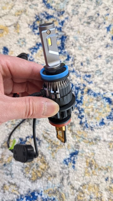

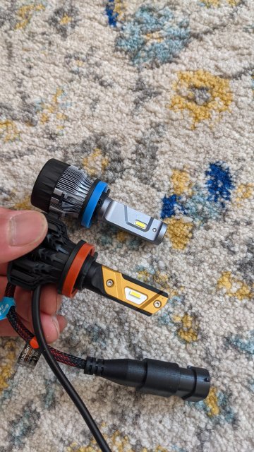

Hi guys, just got a new to me 2017 Fist ! I had a 2015 I sold long time ago and now back! Been picking up a bunch of parts recommended from this forum! For any folks wondering the dimensional diff between the Gen1 mini vs Gen2 min, I ordered both. I hope this helps. I'll document all other parts I'm also putting in on different threads, super excited to be back!

Those are H11s and will definitely fit the fog lamps regardless of which type you choose. Looking forward to photos of the result!

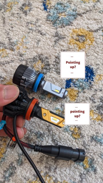

Thanks so much! Glad to see the forum has expanded and so many more parts vendors! Quick question for the orientation of the bulb is the notch facing up or down? Thanks guy!

The notches will prevent you from inserting in the wrong position. Just make sure you don't force it in and as long as the notches align, it should be easy to insert the bulb and then just twist to lock.

Ahh sorry for the confusion, I mean the design notch where the LED sits, should the v looking be facing up or down or does it matter? Thx guys!
