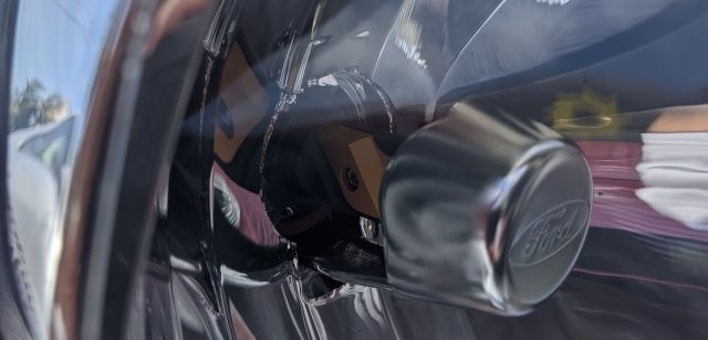

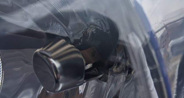

Yeah, it took some convincing to get in there. I actually had to trim a little in the passenger side to get the bulb in there. But no issues since. I'm super happy... For now.

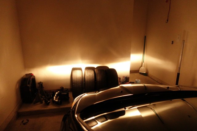

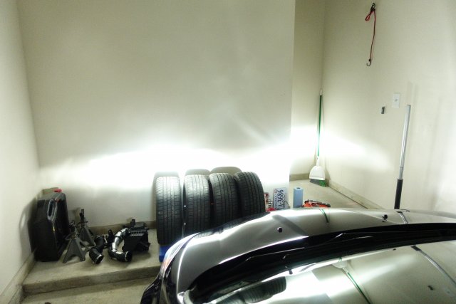

How hard was it to get them in? I'm having a lot of difficulty getting the heatsink to clear the opening at the back.
-edit- Even adjusted as far in as I can get it, they don't fit. Looks like some cutting is going to be required.
-edit 2- Trimming was required. Cut and filed down the lip for the cover on the corner it wasn't clearing. Still tight, but there's just enough clearance now. Comparison shots attached. Taken with an RX100 on the same manual settings for each shot. I'm impressed with how the beam pattern appears to be completely identical.
