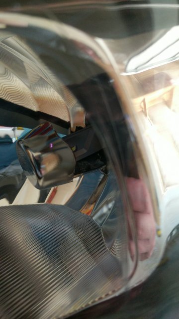

The TechMax are a bit of a tight fit on the passenger side headlight but no, being mini has nothing to do with other than a marketing term saying that they are small to fit in more places... I just laid out the Katana wires/modules behind the headlights in whatever crevices/spots they will go in, not a big deal.... 15646321643632496539451580798186.jpg

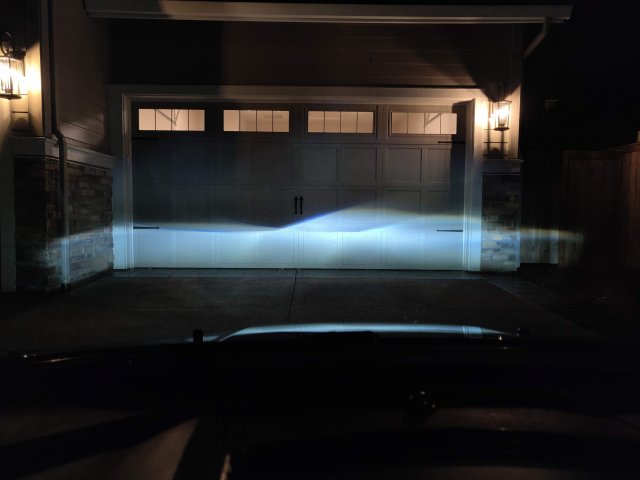

How are the bulbs supposed to orient? Right now the stalk piece is up/down with the leds themselves at 3/9 o'clock.
Are the actual leds supposed to be 12/6 o'clock? Or 3/9 o'clock? 15647759559766462197652340334225.jpg
Yep, you have it right, stalk 12/6, led's at 3/9... How's the output look?
