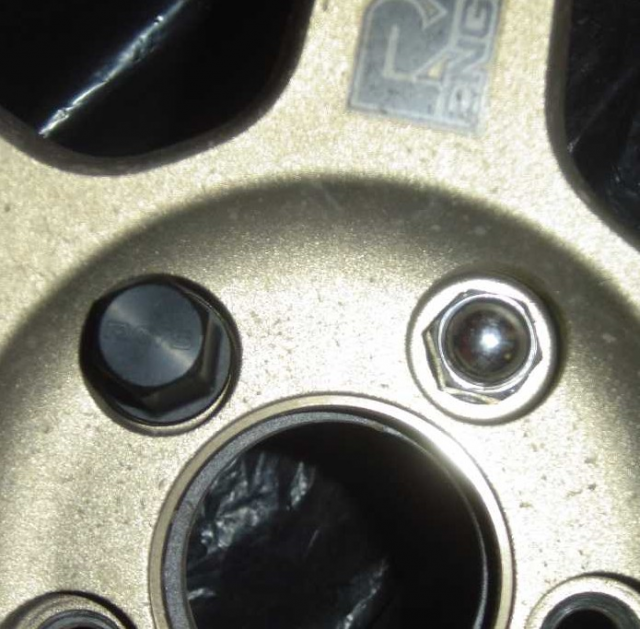

I just picked up an awesome set of bronze RPF1s from Oakos for the upcoming autocross season. This is my first new set of wheels, so I just have a couple of quick questions. First, do I need different lug nuts or can I use the OEM ones? I think I'd much rather use aftermarket lug nuts since I don't want to have to deal with wheel locks anyway. Any suggestions for aftermarket lug nuts? Also, do I need hub-centric rings for with these wheels?

RPF1s actually do not have an issue with lug nut width and do not require spline lugs like many aftermarket wheels. What they do need is a lug nut with the proper seat. This would be a bulge type conical seat of 60 degrees. Most "tuner" and aftermarket lugs have this, whether they're spline or hex.
The OEM Ford lug nuts that come with your car are a bulge type seat but are the wrong degree and length. So while they will physically hold the wheel to your car, they're technically not correct, and could cause failure and/or damage to your wheels.
AN ADDED NOTE: Subaru lug nuts have the opposite problem. Their seat is so short that the hex ends up coming into contact with the wheel when the nut is tightened down.

You know by now the RPF1s are a bigger hub bore than your car, because of this there is a gap between the wheel and the hub.
The general rule with hubcentric rings is: Recommended but not required.
They make makeup the difference in hub size and help center the wheel on the hub when installing, without them there is potential for added NVH due to the wheel being uncentered. Most of the time, if people aren't sure I advise them to get some simply for peace of mind. Simply one less thing to worry about when reinstalling your wheels.
See here: https://www.oakos.com/HCR-W73-6340.htm
