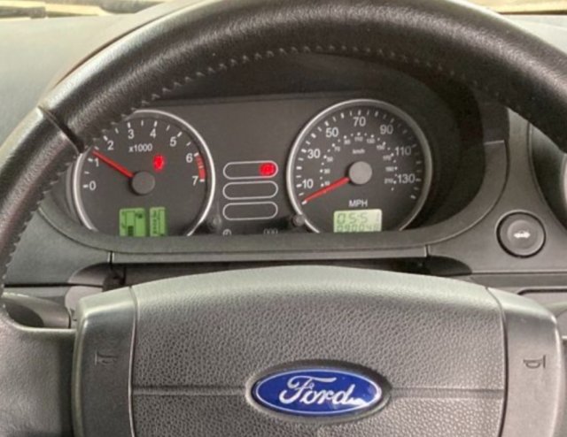

I replaced my ball bearings off all my 4 wheels. Since then when I turn my ignition switch 1 click all lights are lighting up, so that's okay.
After starting the engine only the handbrake and Airbag is lighting. ( Airbag is known, because I build a camera above my back license plate, removed the original radio, putted there a VDO-Dayton navigation system and a BT-radio with MP4 which switch on and also views Al behind the car. Must be a connector, but for MOT not a problem. ) Allready bought resistors at AliExpress so that the Airbag is working.
The ABS is also going off when the ignition switch was turn in position 1 .
Then the RED handbrake, it's on. No problem, I put the handbrake handle down and it's off.
Fine MOT proof.
Now driving, Speedometer is doing nothing under 10 km/h. Above that speed:
ABS is lighting up (orange) not a MOT problem
Speedometer is waking up and gives the correct speed.
Handbrake is lighting up (RED) that's a MOT problem. Insurance will kick the car out and it's forbidden to drive.
You only can drive when you have a mailed or written appointment with the MOT mechanic.
I read all out by the OBD on my Laptop after a reset, did a "brake bleeding" because I replaced all brake lines. The brake is working if you drive frontal with 80 mp/h to a Leopard Tank.
After the issue reading all again out then I got on my OBSTAR X300 Mini Immo and Mileage Programmer / Analyzer.
FR no signal or incorrect signal from the speedometer.
FL no signal or incorrect signal from the
speedometer.
(FR is Front Right and FL is Front Left, for your info)
and of course the airbag and ABS errors.
Because I don't have a pinout off the PCB/Cluster it's a piece off cake. I assume, that to the red led there are 2 connections. One positive line to the led by the handbrake switch and the other one by the brake-oil switch. Just desolder the pin from the brake-oil won't lit it. Have time enough later to solve it.
The speedometer will not be noticed by the mechanic cause they are only allowed to drive from the garage door into the garage. The brake test will break his chin on the steering wheel.
So the question is: has somebody or is there somebody who has the pin-out off the connector from the cluster (Fiesta/Fusion 2003 EU-left EU-right are the same) see photo. A diagramm is also fine
Has somebody a solution for the speedsensors. Must really be speed an do also something with the ABS. First I thought the speedsensor was on the gearbox, but there wasn't any. On my other car the Fiesta 1.4 the speedsensor was it fitted on the gearbox.
Also can't find the ABS problem. It has to to with the FR en FL. I don't hope that it is a from a to b to c to d to the end off the alpabeth errors.

The speedometer uses feedback from the two rear wheel ABS wheel speed sensors rather than the gearbox. The front speed sensors are used to detect wheel spin for the traction control
Given that you replaced the wheel bearings, did you plug back in and reinstall the ABS sensors properly? It’s also possible the ABS sensors or wiring got damaged during the process.
Are you using Forscan, and are there any codes stored in the ABS unit itself? If the ABS light is coming on, it should be storing a code. Your OBStar unit might only be reading from the PCM/ECU, which is typical - try driving around then checking for codes in the ABS unit with Forscan
