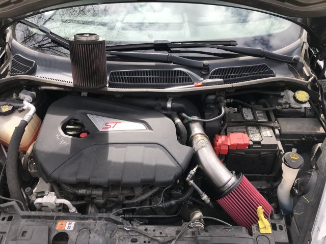

I'm running a hot air intake (MAP with an AEM filter) :cool: with a Mountune crossover. Whoosh V3, probably a little too much intercooler but I like to think I'm balancing out some potential lag with the overall intake setup. On E30 it all just sounds nuts and is so responsive. I see the downsides but it's been a cheap and fun way to go for my wants.

Tons of good options. Unless I needed a 3” diameter, I’d go for the ST200. I have had the Mountune, Whoosh ram, ST200 at various points. All great. Didn’t love the noise of the whoosh. Have a 3” 2J and a 3” Cobb carbon fiber in the garage to install one of when I swap turbos.
Between your two choices, I would go with Whoosh since it’s significantly cheaper and both will give you the same performance.

Well going with MAPerformance catback for my 2017st Fiesta thinking also of a cold air intake not short ram can't decide on what brand maybe k@N need some help on this one not to loud and will not set check engine light on thanks
There aren’t any true cold air intakes for our car aside from the 2J cowl intake. They all place the filter in the same location. Any that use an open cone filter (no air box) will be pretty loud. No intake will set off your check engine light. Also FWIW, intakes really don’t add any power.

Best performance value? Stock airbox with a high flow drop in filter. The intake on these cars is decent from factory. Another "factory" option is to upgrade to the ST200 airbox (about $280). Plenty of people have done that in this forum and have had great results with air temps. One of these two options would be my suggestion just because they're so functional and proven.
Purely sound? I have a Whoosh V2 Short Ram and it is hilariously loud, so loud that I went back to the stock airbox. The turbo spool and blow off noises sound like a Fast & Furious movie. I believe the loudest intake you can buy is the 2J racing cowl intake.
so just getting the st200 air box would be a big improvement on the st don't want crazy loud just better performance and sound do have a MAPerformance catback and best brand of drop filter if adding a induction pipe make it very loud
