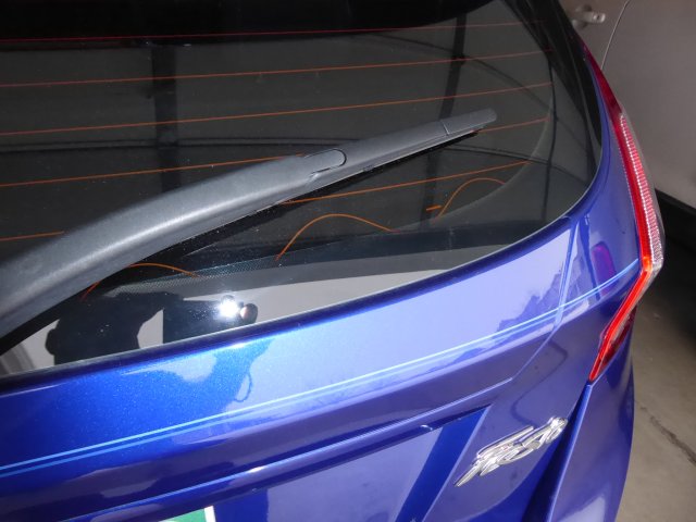

The bottom grid line on the rear window defroster of my 2014 Ford Fiesta ST is broken and deformed. I just noticed this the other day so it must have occurred very recently. My rear window was tinted 6 years ago when I purchased the car.
What is the best option for fixing this? Can it be repaired or replaced and what type of cost should I expect for this type of repair?

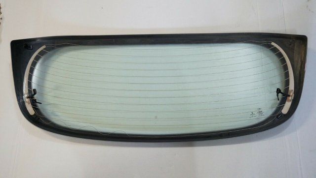

After speaking with an auto glass expert I have discovered that this wavy line on the rear window heater is normal on a 2014 Ford Fiesta ST and the rear wiper actually dissects this wavy line when at rest. The purpose of the wavy line is to remove ice from the rear wiper when the rear window heater is turned on.
I found this photo of a Fiesta rear window which shows the wavy line as well. I appreciate the response, but please disregard my prior post as the wavy line is completely normal.

There is no break in the defroster. It was my mistake. I thought that the wavy lines were a break in the defroster, but they are not and that is a normal condition.
