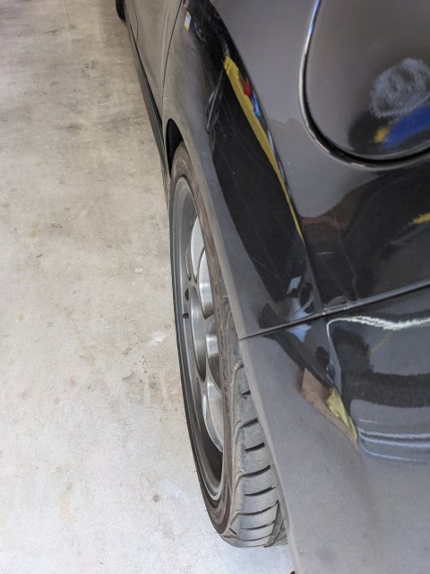

So I just replaced the brakes on the new-to-me FiST I bought a few months ago. Pads, rotors, lines, fluid.
I also removed the cheapie shim spacers that were on the rear wheels.

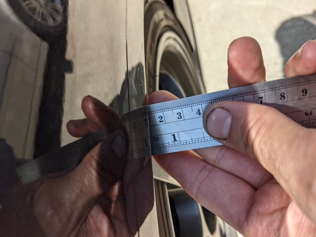

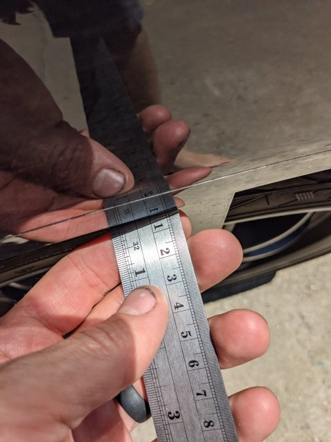

When I got everything buttoned up today, I noticed that the rear wheels are not uniformly set in from the fender. I lined a straight edge against the wheel face, and got about 13mm to the fender on the passenger side, and only about 4 on the driver side.
Is there a way to fix this? Can I recenter the rear beam by un/re-bolting it? Is there any play in the way it mounts to offset it to one side or the other?
I'm attaching some shots of both sides, with measurements.
Passenger:
Driver:

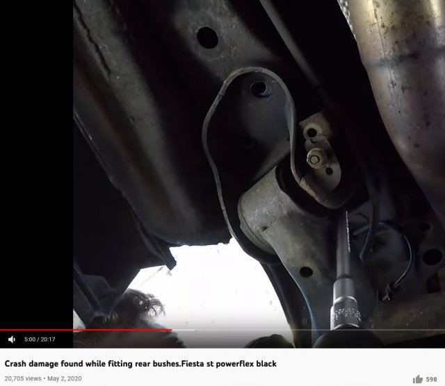

Ok... to answer my own question - it seems that the rear beam is held in place by 3 bolts per side, and the hole is elongated.
From a Spark Plug Steve video:
Time to crawl back under the car and do the fiddly job of getting the damn thing centered.

Mine gets tweaked every now and then. My alignment guy uses some crazy long tool to move it and realign the rear beam after loosening those bolts. I thought I was the only one that had this problem. I’ve knocked it way out after accidentally getting the passenger side off the ground.

I was thinking about the one side thing. The way you have to jack this car up (one side at a time) to get jackstands under it puts a lot of strain side-to-side. If those bolts aren't super snug, I bet it could shift just from trying to get the car in the air. I really need a Quickjack!
