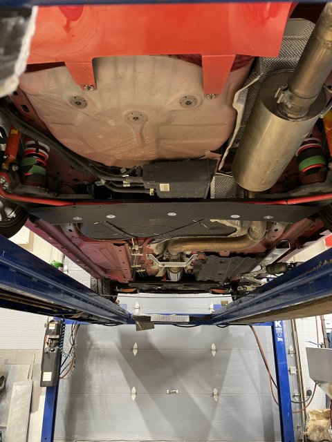

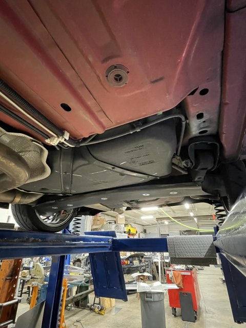

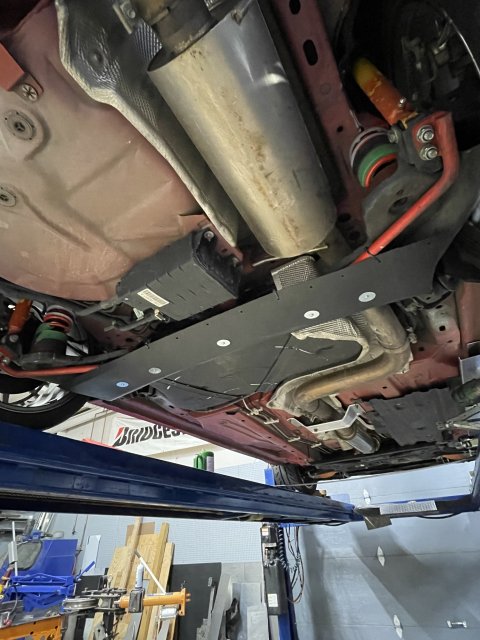

Finally got the hardware for my rear beam closeout panel. I think this turned out pretty nice for my first time forming this plastic material. Its got a nice rounded nose on the leading edge and I turned up the back edge to help fair that air smoothly off the panel. Kinda sucks now I won't have my central jack point at the rear of the car now though. :(

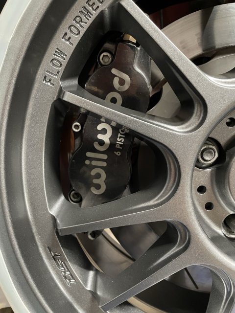

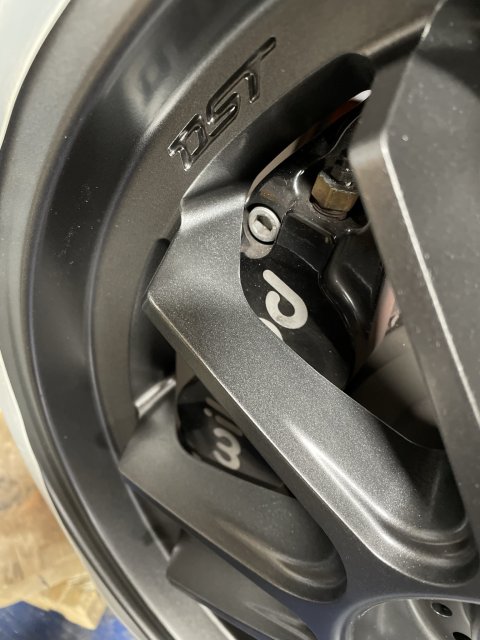

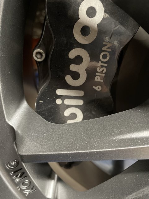

Got a set of 17x8 Hypergrams today. They don't come with centering rings and the center bore on the wheel is 73.1mm. Guess I am gonna have to make my own aluminum hub centric rings. Konig doesn't even show an aluminum one. Not using the plastic ones. They will help under track usage.
First bolt up, no spacers, just wheel on the rotor like my Rotas.
71348824050__39703564-912E-480D-84A7-AA1BAD58F392.JPEG 71348825922__E481E976-7540-4CFC-B057-64CB70CAED25.JPEG 71348864830__B01B6215-BF8F-4141-ACCF-7A739D6F92EF.JPEG 71348885138__A0C57882-C531-4E1C-9E36-E37EE2FB02CC.JPEG
Houston, we have a problem!!!!!!

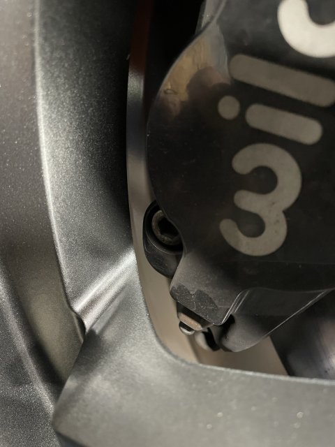

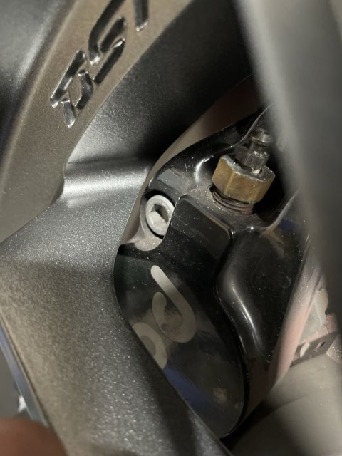

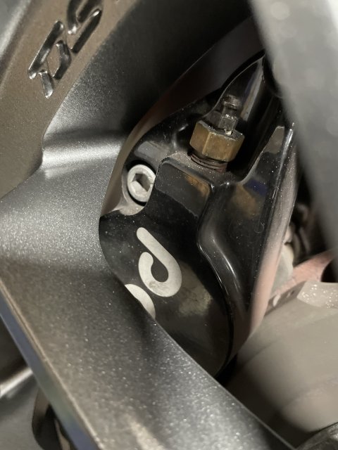

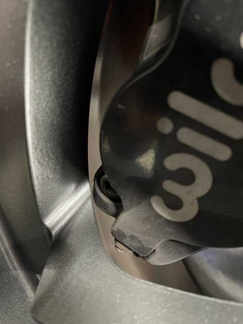

Welp, that is a fail. These are a 17x8 ET40 wheel. Lets try that with a generic 3mm/.125in spacer.
Well that is a little on the close side. That is about .5mm/.020in. Good sign though. That is my closest contact point. Lets try a 6mm.
That is a little more than 2mm/.088in. Plenty of clearance without going to a HUGE spacer. So I can order 5mm spacers from H&R but they only sell them with the longer studs, I already have the longer studs and I happen to have a hunk of 6in 6061 aluminum round bar. Guess I am making my own spacers and hubcentric rings.

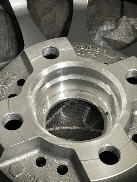

I am a little disappointed in what I would consider an odd machining finish on the back of the wheel hub face. Anyone else run into this? There is a weird step halfway through the hub face.

The step shouldn’t be a problem - it will help them sit flat near the studs even if the hub face isn’t as flat as it should be. I believe the Dekagrams are the same. Why they didn’t bring the step all the way under the bolt, who knows?
I could have made my own, but ended up finding a set of cheap aluminum hubcentric rings on eBay that were reasonably well made (for flea bay stuff - read decent surface finish and actually concentric), with clever silicone orings to hold them in. Between the orings and anodizing, I’d have a hard time making them cheaper myself.
73.1mm is a common aftermarket size that Konig and many others also use.

I don't see how the lug nuts don't put a bending force on that hub face when tightened down, plus I am not sure there would be enough contact patch to keep from introducing a shear load into the lug studs.

I’m sure there’s theoretically some bending going on with that step, but the hub is so thick between the lug nut seat and the hub face that I’m not that worried. Still an odd design, but I’m sure there’s a reason for it.

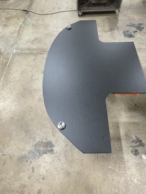

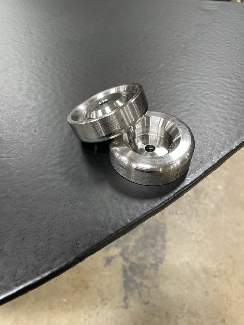

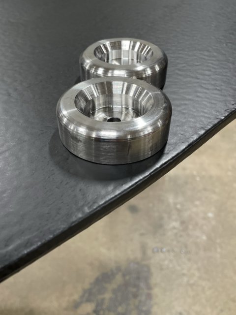

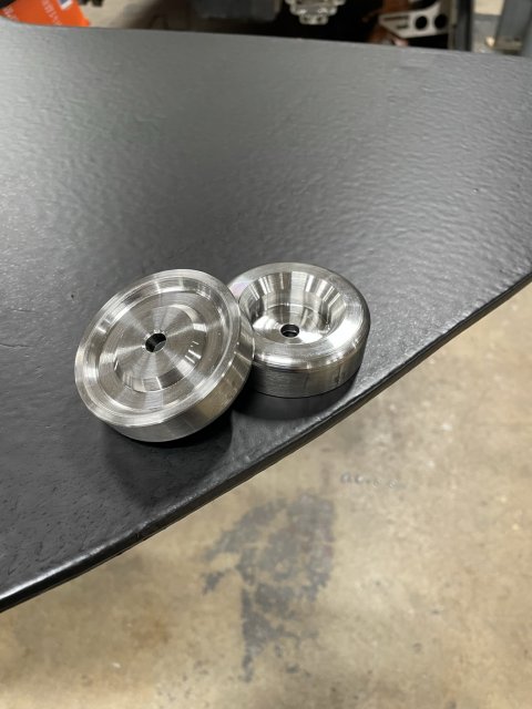

Because I am a dork, have a machine shop at hand, and have 200lbs of titanium bar in the corner, its time to make some splitter rub blocks so I can shoot sparks on corner entry. These are 2.5in of 6AL 4V titanium .750in thick. That will get them within 2.25in of the track at ride height and once the car rolls into the corner and settles on the springs, hopefully sparking away. HAHA.
Also got the last coat of paint on the splitter today. It should be dry tomorrow. Also got a shipment notice from Send Cut Send on the splitter brackets. Hope those show up next week. Now to play with where I want to mount these blocks on the splitter.
