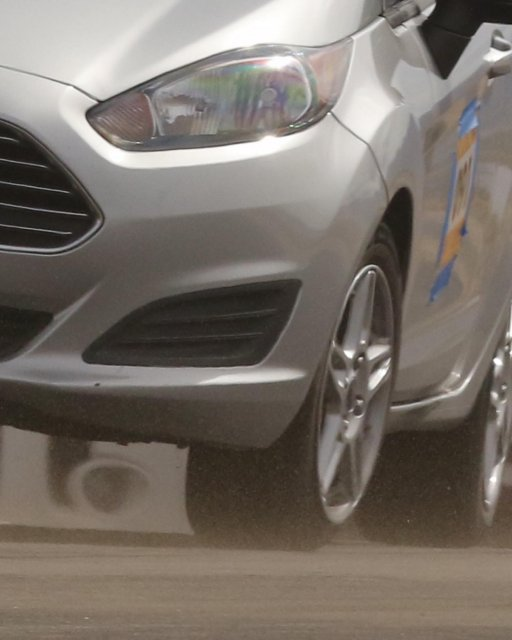

I had a bizarre experience at last weekend's autox where I was trying out new set of RE-71RS in 215/45r16. The front pair running at 43 PSI (which I gather is a fairly high pressure) was rolling over onto sidewall in hard turns. Few years ago I was running the original RE71R and did not have this problem. Front camber is at -2 degrees which is more than I had with RE71R.
The only other thing that stood out is folks at the event commented about the amount of nose dive on the outside front corner during the turn. So now the question is whether the stock suspension is too soft or has worn out, allowing for extra flex, and what can be done about it. Someone suggested to install a rear sway bar which would theoretically make the rear rotate earlier before the tire collapses, however wouldn't that make the car unstable in slaloms? Camber bolts will likely allow for another half of degree but this seems like a bigger problem than that half degree can solve.
Has anyone gone through the same with their Fiesta?

What other mods? How wide are your wheels? Those are fairly sticky tires for a stock suspension ST.

That is pretty odd, I wouldn't expect much rollover at that kind of pressure (although i have no experience with the new Bridgestones. One thing you might want to check is if your tire gauge is still accurate, but that's about all I could think of.

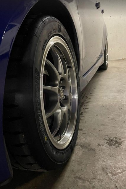

Rims are 7" wide Enkei j10. Tire walls look pretty vertical, i.e. not leaning in or anything.

Yes, I've been suggested that the tire might be overworking the suspension. The only confusing part is like I mentioned earlier I had similar tire on the car and it didnt have these issues. Also seeing how other Fiesta owners successfully compete on Potenzas in HS without major suspension mods makes me lean towards worn out strut theory, they would be turning 10 next year and the car has been autocrossed every single one of them.
But yes, seeing how Im in STH, I would also welcome mod solutions on how to make the front roll less without changing the car dynamics too much.

2- a 215 wide tire is way too big for a 7" wheel. for a 215 tire you should have MINIMUM an 8" wide wheel. Otherwise you could probably run a 195 and get the same if not better results. Your 215 on a 7" setup will cause the sidewall to flex and make the car over work the sidewalls.

Interesting, but wouldn't a stretched tire be more prone to rolling over onto sidewall since the sidewall is already leaning towards the ground due to the stretch? But I suppose if there's enough camber, that takes care of that...

The other thing to consider is that 8" is NOT stretch for a 215/45 tire. the recommended rim width is 7-8" for that size. The car came with 205s on a 7" wheel. That's a perfect fitment. The 215 is oversize for the 7" wheel. The 8" is the right size.
FWIW this is how the fitment looks like right now... Did not look distinctly different from how old RE71r looked like in 205/50 so I didn't think twice. Going to see if I can find any rims in 7.5-8" width.
