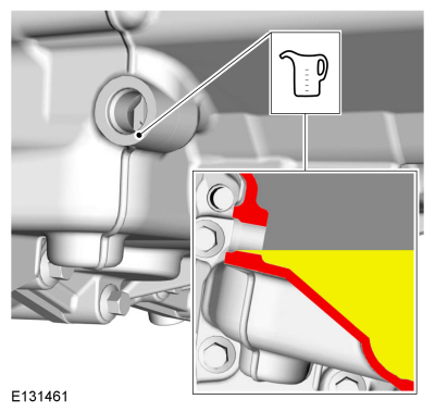

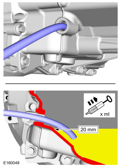

Going to change the Transmission fluid this weekend. Would like to to make sure and confirm its a even 2 liters of the Ravenol MTF-2? That's to specs and not to much or little?
kivnul
U.S. Army Veteran
1,199
720
Deer Park, WA
Specs is to add fluid to overflow and then subtract until you measure down to a set MM below the hole. Most folks agree that 2 liters is just fine. (Its what I use for what it is worth)
4. Material : Motorcraft® Dual Clutch Transmission Fluid / XT-11-QDC (WSS-M2C200-D2)
5. NOTE: Remove enough fluid to be 1 in ( 20 mm) below fill hole.
