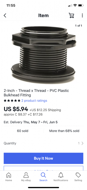

Hello ladies and gents, been on the fence with the st200 box... what do you guys think about just drilling a 2” hole in the bottom, threading in one of these and then having a hose clamped on and routed in a similar fashion as the st200?
Just stumbled upon this, thoughts? Stay safe guys

I bought the ST200 box from Ron@Whoosh. I love that it's the engineering of Mountune and Ford and the stealthiness of it. A modified stock box just isn't the same. If you see both you'll understand otherwise Ford could have just done that and saved a ton of engineering money instead of making a whole new box just for that run of ST200s.

Oh no doubt it is a nice piece, love how there is no hacking and is stealth! May just have to bite the bullet and get it.

I did drilled a 2 1/4 (correction from my 2 1/2 that I thought it was earlier) hole at the bottom of the air box and stopped at that point (I should of made it a 2 inch hole instead)I like that I do not have to snake the hose around underneath. The ST200 setup looks better, but I have yet to see a comparison in performance between the often derided “hack job” hole and the ST200. Maybe it’s more noticeable with modified cars.

I did it awhile ago. I felt a slight difference with a hi performance filter...more noise than power I think. Im on a stock tune though. If I did it again I would have made a 2 inch hole or if I’m concerned about the “look” for emissions inspection (the hole is underneath.. lol ) the ST200 might be a good upgrade. But if I do spend the money, I don’t expect any power difference... just a lighter wallet. The better money is spent on a intercooler if u get a tune or live in a hot climate [for more consistent performance]
