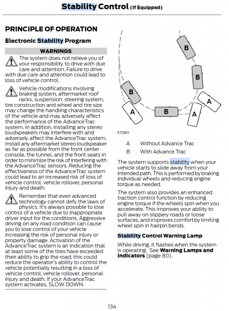

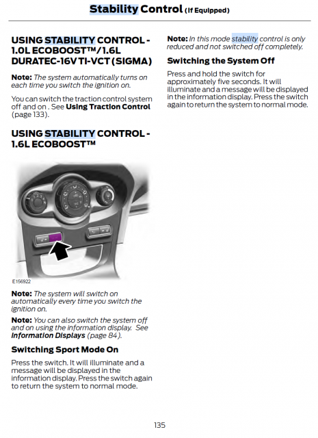

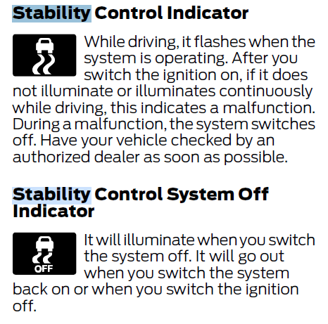

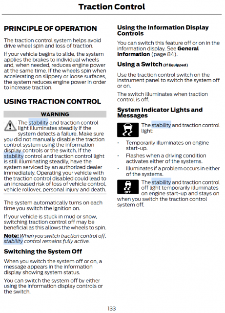

I think I recall reading that electronic stability control cannot be completely switched off but don't see it in the owner manual.
Maybe it was torque vectoring (Advance Trac) trying to "point" the vehicle. Maybe that'd be a bit less subtle with a big brake kit installed?

if you hold it down momentarily it will put the car in Sport mode with some nannies still on if you hold it down for 3 seconds or longer it turns everything off. I am not sure what happened but I never had any issues with it doing a engine kill inadvertently . I know track guys have had that happen but you really have to rail the car hard and if you are still running the extreme sports still it will most likely lose traction before you trigger the crash control . You have to rail it with super stick tires to activate that.
