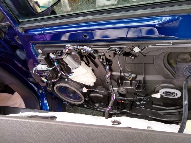

Thread Starter #9
Here's a picture I took when they took the door panel back off. I just thought I might be helpful to know what it looks like in there for future reference, so I'll post it here for anyone who wonders what it looks like inside their door panel. IMG_20190619_144745924_HDR.jpg
