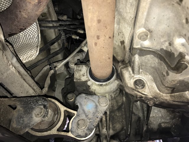

I can get you a picture of where the seal is. What i don't have is pictures of the damage. Because this was supposed to be a warranty fix, the dealer... well... doctored things on their end. They applied silicon to the gouges in an attempt to seal them, installed the new seal, and then put it back together quickly. TECHNICALLY they should have charged me for everything. But because they felt bad given the situation, they did it this way, and just made sure it looked ok on paper so i wouldn't be charged anything.
My concern is this is just a bandaid. I know the damage is there. I know its going to come back when i get a leak or the seal fails. And i KNOW im going to be right back here again when that happens. So I am very, VERY sorry this is all as vague as it is, believe me, id be under my car right now with a flashlight and camera to provide you guys with anything i can! But like i said, im not a car guy, and i am very lost and overwhelmed with this. =(

Ok, so, I couldn't get under my car tonight, but i did find a pic online of the spot.
From what was described, they used a tool between the housing and the seal to pull the seal out. (Prybar, screwdriver, what have you...) and in doing so, put deep gashes in the housing. Its that housing (Not the seal) that now needs replaced. Does that make sense?
