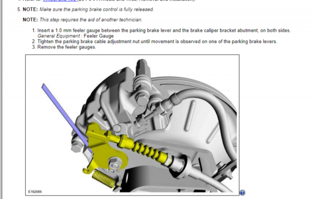

There are a couple springs, on an 2004 VWR32 my buddy had it was a frozen actuator at the rear parking brake assembly that was causing the issues with the brake (tho on that the cables were coming un-hooked at the console in the middle and the parking brake was dragging, the lever would ratchet and stay locked just fine and release, but the caliper itself had the issues outside the car)

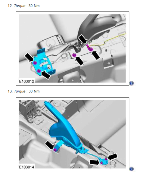

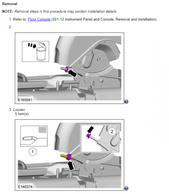

Unfortunately the service manual does not show disassembly of the "parking brake control" (lever) to diagnose a broken spring in that system. it just shows how to remove it and replace.
Any chance you have the service manual for the ST? it does a nice job of showing how most of the sub-assemblies go together and how to diagnose. if not, I can share the one I got on the forum a while back.
but to disassemble the parking brake assembly you have to take apart the console, its not all that difficult, just plan on it taking an hour or two to take apart and put back together. the videos on replacing the shifter bushings do a good job about how to take apart the console to get at the assembly. beyond that point you may be on your own as to figuring out what's inside the lever.
176
179
St. Paul
Here are a couple pics of the parking brake lever assembly removal if that helps at all
