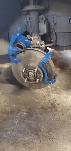

No need to remove. Just rough it up real well with sand paper. Start at 600 grit. Then prime and use 1000 between two coats of primer. Then do your color with 3000 or finer grit. Youll want at least 4 coats of color. And let the paint cure completely. So it doesnt gas out and wreck your next layer.
