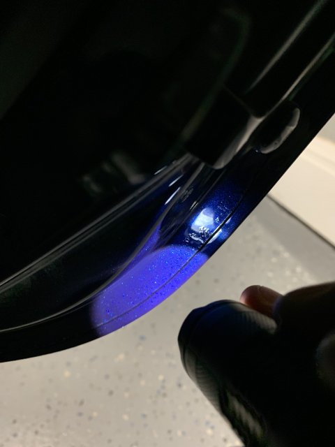

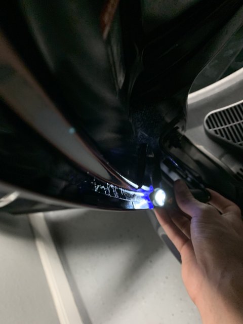

As some of you may be unfortunately and acutely aware, the paint quality on our cars can be rather crap.
Two of the most common manifestations of poor paint quality on the FiST that I have witnessed within the community are:
  • Bubbling on the inside edges of closures (doors, hatch, hood) and around the roof antenna, caused by poor adhesion and/or corrosion underneath the paint with no apparent external damage
  • Poor adhesion on plastic panels and trim such as the fascias and door handles
I myself am affected by the first issue. My vehicle was produced on April 16, 2018 and currently has a mere 9,600 miles on it. It has always been kept very clean, especially during winter, and yet each of my closures has varying degrees of bubbling around the edges that has begun to rapidly deteriorate since about two or three weeks ago. The point of bringing this up is to illustrate that even a relatively new and well-maintained FiST can be affected by this and it is almost certainly NO fault of your own.
Thankfully, you are not without hope!
Be sure to read through this relevant General Service Bulletin direct from Ford to determine what is a warrantable paint defect:
>>>GSB 19-7033 - Paint and Bumper Concern Analysis<<
And also be aware of the warranties that come with your car (the bumper-to-bumper and corrosion perforation should be the most relevant):
If you are affected by a warrantable paint defect and are under warranty, press your dealership to fix it! Depending on the dealer and the decision-makers at Ford, they may try to deny you with a weak excuse. Use this information to make them honor their responsibility!
Last, but not least, read up on and know your local lemon laws!
I am currently waiting for my dealership to receive a response from Ford to determine if they will cover and correct the defects, and will update this thread as things progress.
Examples of my defective paint:
View attachment 22328 View attachment 22329
Please feel free to add your own examples and experiences in this thread!
