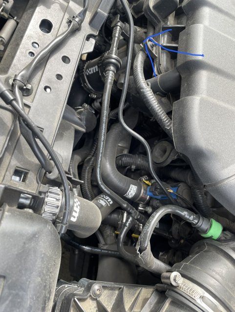

Which Evap line did you pull? The one on the front of the manifold that’s above the throttle body (see attached picture) or a different one? Pulling the post throttle body Evap line in the photo should cause the engine to rev up rather violently and hit the rev limiter (ask me how I know when I forgot to hook it up 🤣).
If it doesn’t do that or also doesn’t run right when given throttle the problem is likely elsewhere, maybe fuel or ignition system. Check that coil packs are seated as a first step and pull the spark plugs to see if anything obvious is going on there (rich/lean/fouled)

The part you have pointed out is what I pulled. Popping it out makes it idle almost totally fine.

Codes are weird - sometimes they are accurate, but the ECU is basically looking around with a blindfold for odd signals or behaviors, and it doesn’t always catch it till it gets really bad and sees a very obvious pattern of signals either repeatedly or for a long enough duration to avoid flagging false codes. Basically it looks at symptoms and has no idea of the actual cause.
Pulling the hose I pointed to should definitely cause the engine to rev to redline (basically it that allows air from outside to bypass the throttle plate). Check the idle valve, but it’s likely something else. All that code really means is that the ECU is having trouble controlling the idle.
