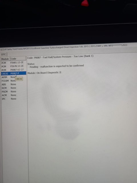

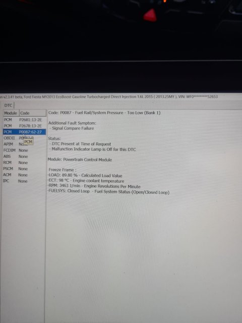

Hi guys,
I'm hoping someone can assist, as we're having trouble diagnosing this issue. We've replaced the low-pressure fuel pump, as well as the fuel tappet, the high-pressure fuel pump appears to be fine, however.
Any advice would be greatly appreciated on this issue (P0087 Fuel Rail/System Pressure Too Low (Bank 1)).

If it was a lowside issue it would be generating a p008a code.... That's a hpfp side code... Have you guys checked if commanded is matching actual? Do that for the fuel rail sensor and the lowside sensor, you should really try replacing sensors before you get to more expensive stuff. Both of those sensors are dirt cheap, Amazon has the lowside for 35 dollars. I just had to buy one cuz I have the p008a

LFPS would cause a p0087 as there would technically not be enough fuel in the lines, causing the code.
Just went through this code, and LFPS was stuck reading 108psi on idle/revs.

Well, im not the original poster here, so I assume you were asking him. If you are referring to me, I already replaced my LFPS(seeing as it was a $30 part, why not), and it now reads 70-100psi depending on load.
