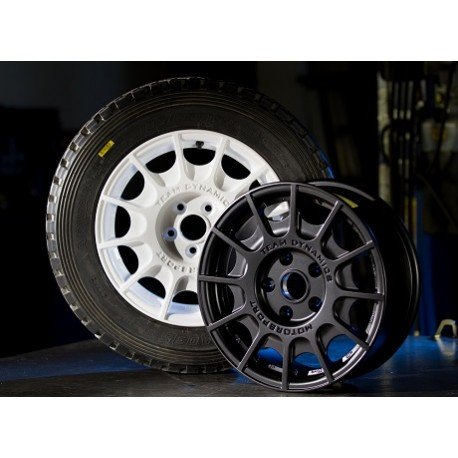

Ok so essentially unless you’re in the rally world they are un-obtanium. The next best option I see are the TD Pro Rally wheels.(pic attached) They aren’t super expensive either. Thoughts on those? I’m also going to check out those speedline wheels.

IF you can find them, or order them directly from Rimstock in England, which you may have to do now that there is NO U.S./North American based distributor for them, they are stronger than the Method MR501 VTs (which are ALSO no longer made in our fitment [:(]), but still weaker (but slightly less $$$) than the Speedline 2118s.
14,418
6,972
^^^Those are NOT as strong as all of the wheels mentioned in my post above, but they are relatively strong, and very good looking. [thumb]
That being said, there was an ARA rally crew out of the PAC WEST which ran them on a Limited 2WD class FiST last year (I will not know which wheels they are running this year until I see them at NEFR in mid July), and supposedly never broke one, even on the roughest rallies in the land, so they maybe ARE a bunch stronger than I realized. [dunno]

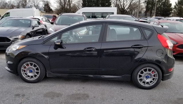

Oh I am well aware they are not serious WRC-caliber sh!t kickers, but aesthetically they fit the bill and on unpaved roads they have never done me wrong...
I can't say I use them for stump jumping, but I have definitely put them through some hard driving without an issue...and each one is 5 -6 lbs lighter than the stockers which I also appreciated.
I think, at 15", the durability is affected by sidewall stiffness too... some bounce to the ounce with my winters definitely helped.
This setup is why I ended up with 15x7 Ultraleggeras for summer... 13 lbs shed per corner was very enlightening.
