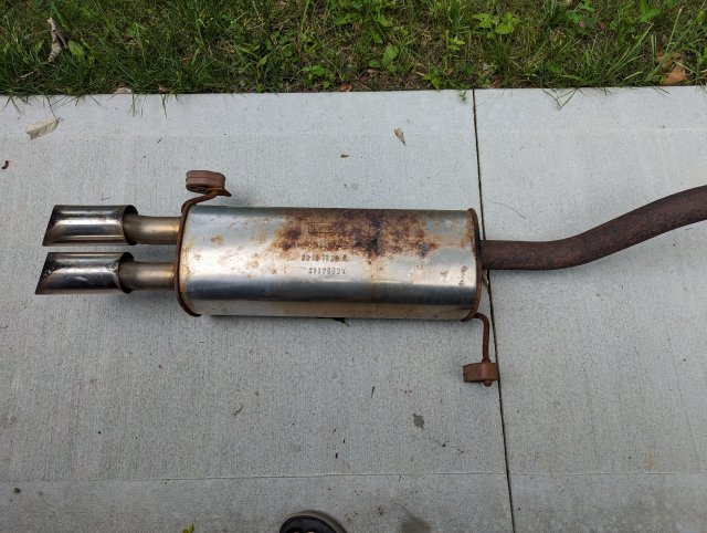

Sorry for the Necro bump, but I have a 2019 as well and am also in Ohio and my exhaust has rusted all the way through and is leaking by the bend before the rear muffler.
Is this typical? This metal can't be stainless, can it? My Golf R is one year older, has seen double the miles in the same winters, and barely has any rust on it at all....just some patina. This pipe is totally coated in rust that is flaking off everywhere and has at least one hole in it.
The mufflers, ironically, look about online with the 409 stuff on the Golf.

No way I'm gonna buy a replacement stock exhaust. I ordered a Thermal R&D to replace it because this car needs to be family friendly.
I'm absolutely stunned that an OEM exhaust could not just look corroded, but RUST THROUGH in 4 years. There's no way this pipe is stainless.

🤔 not sure I agree with that. I don't necessarily care that much if it doesn't, and there's nothing I can do about if it that's the case, but I've never seen 304 rust in Ohio winter...let alone rust enough to lose structure. Crack maybe in very high heat applications, sure, but not meaningfully corroded.
Our Golf R's OEM 409 stuff barely has more than a patina on it after 5 winters, and the Milltek 304 stuff on my older Golf just has discoloration on it after over a decade.
Not sure what it's like where you are, but it sounds way worse than where I am.
--Matt

High grade, true austenitic 304 stainless has to last longer than 2-3 years before perforation, regardless of the gauge, unless it is totally immersed in Dead Sea water.
Maybe some of the OEM manufacturers are using something even below 400 level stainless for their 'economy car' systems now, if that even exists in the stainless steel range? [dunno]

I hear your words. That pic doesn't look anything like meaningful corrosion, though, just cosmetic stuff. Who cares what it looks like honestly, it's under the car. Just about anything will corrode to an extent in a harsh enough environment, but 16 gauge 304 on a vehicle exhaust won't corrode to the point where there's a hole in it in 4 years.

Not necessarily. Wall thickness (or lack there of) in addition to environmental conditions, influences the rate of oxidation. Heat, salt brine, sources of oxygen will oxidize (rust) any grade of stainless in short order.
Maybe some of the OEM manufacturers are using something even below 400 level stainless for their systems now, if that even exists in the stainless steel range? [dunno]
Yeah, agree. The OE exhaust pipe may not be stainless at all, from the look of it, but if it is it must be some real low grade crap...and just a notch past paper thin.
--Matt

I am certain this muffler is stainless, and the pipes coming off of the back of it. This stuff looks like the 409 that's on our other cars. The piping from the flange on the header between everything just can't be though. 🤦 Maybe it had some coating on it, but even the spot I cut through in a cleaner area was almost entirely rust all the way though.
The Thermal R&D system fit beautifully, as one might expect, and is the super tame outcome I was hoping for.
