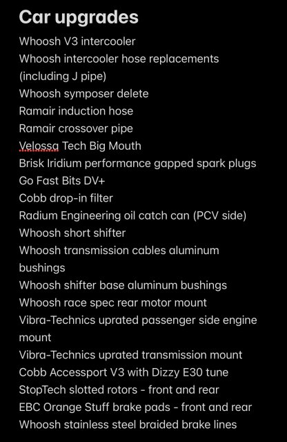

I’ve included the list of mods I’ve done to the car over the years for reference. Most can be ignored regarding this issue.

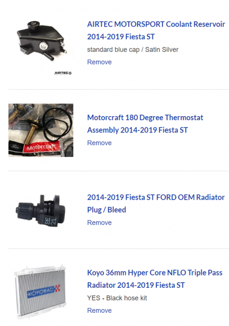

I think this will take care of all of my issues. Btw, the fan seems to be functioning as needed so I don't believe that's the issue.
14,414
6,970
Eventually, I would also like to get all of that order above as well, minus the lower temp thermostat, as it will already run way too cool in the winter for my tastes in combination with everything else listed. [wink]
