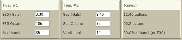

Ethanol Tests kits are like $20 on Amazon. Basically, they're a must. I'm gonna get one, even though mates from my car club reported true E85 last spring, but that could have changed since then. E30 Mix.PNG

These are the measurements you need. These are with perfect ratios mind you, so it'll never be exactly perfect. View attachment 22715
Thanks hyper. I can't help but wonder, what will actually happen if a tad more than 30% is in the tank? Like what if it's 40 or 45? I know the octane isn't the issue, something about the injectors can't move enough liquid since the ethanol needs more liquid volume to burn? But at what point will that be an issue?
I may just get one of those tester kits but what about just saying, ok 51-85% so i'll split the difference and say it averages at 68%, and do calculations based on 68%? Would that be so far off from whatever people are actually getting that it will just go boom?

I would try to avoid that if possible since I honestly don't know what would happen. I guess if you did the math and calculated the correct percentages it might work, but that might be a question better suited for a tuner.
