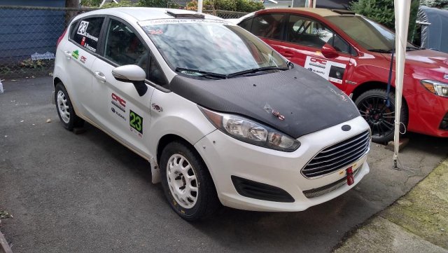

Back from the dead in case if some one wants to hit the gravel:
for M-Sport gravel dumpers on ST one need to use n/a Fiesta front knuckles and even though
have to shave a bit off the lower part of front dumpers. no biggie.
also preferably rear suspension beam as well since it has more flexibility than the ST one.
I also raised up intercooler by about an inch since stock sits silly low.
Anyway they survived 4 rallies and now not as good on rebound
looking for replacement inserts.

PS again lol. the red car is a new WRX I just finished building and if You're curious it sits on DMS 2-way adjustable suspension
