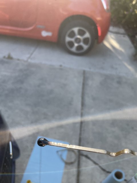

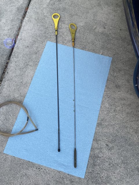

I’ll contribute to the “obscure must have mods”
Quinton Hazell metal dipstick from the UK. A little hard to get ahold of, but for $14 plus shipping (total $35), it’s been a significant life improvement, being able to quickly and visibly read the oil level (generic flat metal dispstick) compared to the annoying plastic torpedo

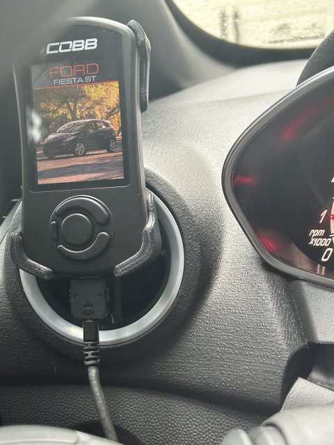

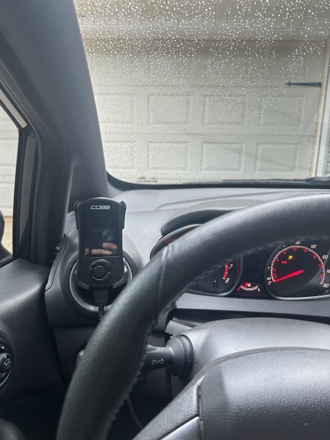

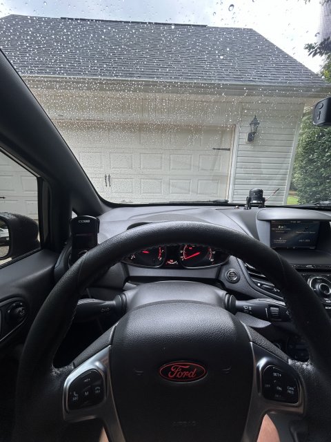

Just moved here in may. In between statesville and hickory! Also in the attachment is a little redesign to raise the AP up about 35mm; Alittle over half way up the vent so the bottom half of vent directs towards the driver.
more pictures of the new design. Air vent definitely has more airflow now and I think it’s in a perfect sight line now too not covered by the steering wheel. No wobbling or chattering noises overall a great improvement!
