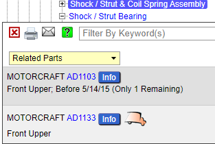

It does not. That is just the top plate with studs. The lower part which is the bearing is separate.
8V5Z-18198-B - (Motorcraft number is AD1133) and i think its $35-40 from what i remember.

OK thanks, that's the conclusion I started coming to as well.
If I'm replacing springs/shocks/struts etc. at 100K, I should do BOTH the strut mount and bearing as well I assume? Or do the strut mounts typically stay fine and only need a bearing?
My car is a 2015...IDK if it's before or after that date, or if it really even matters. Maybe 1133 replaced 1103.
KYB SM5880 is $33.79 and includes the bearing.
FoMoCo is $58.79 and requires the bearing too.
I like OEM where possible, but, don't know if the KYB is just as good here.
Look at your driver’s door jamb sticker, it will list the month your particular car rolled off the assembly line.
