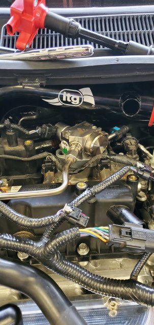

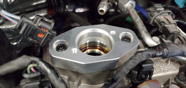

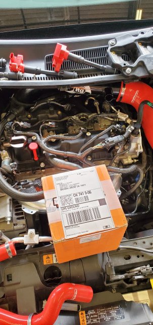

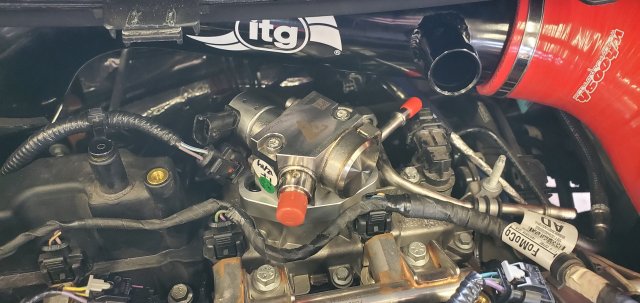

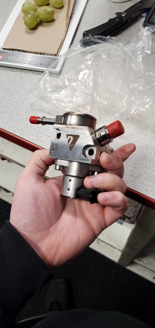

Good morning folks! Nostrum High Performance has released a new high pressure fuel pump for our wonderful little cars. Mine got delivered on Thursday. Install was a breeze and everything fit up very well. I am two days into driving it and it works perfect so far! I had a full tank of e30 and Adam at tune plus wanted to switch to e50 so I had to drive about half a tank of it out to fill back up with E, equaling out to about e50. I will post further experiences once we get into a little bit of power! Previously, the fuel system was stock aside from a set of bosch 30% injectors, s280 turbo, and all the other usual bolt ons. Based off of vdyno, dragy, and actual drag strip runs, I believe it made in the 340-345whp range. Hoping to tickle that 400whp mark soon! Attached the install guide for anyone that has any questions.
