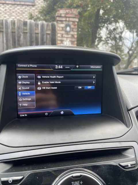

Hey everyone, i’m pretty new here and this will be my first post. Got a 2014 FiST in June and have been loving it.
Was wondering if anyone knows why pressing my ESC button or holding it down does nothing. Also in the vehicle settings the only option available is hill assisit. Sport/track mode are nowhere to be found. My codes are clear and I have struggled to find anyone else with this problem.

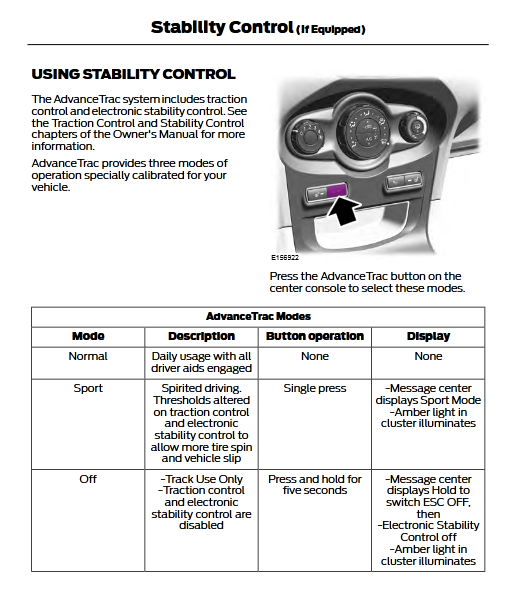

It should illuminate on the guage cluster (yellow). Press ESC once to enable sport mode and hold for five seconds to disable.
I read the same thing in my manual and online but the ESC button doesn’t do anything at all no matter how long or short I press it.
