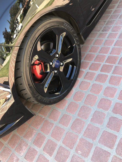

Are you running it on stock wheels? I feel a 215/40 should be run a on a 8 inch wheel . Running it on a 7 is going wide which could cause extra sidewall flex. 7 inch wide wheels are kinda sucky to begin with IMO.
Also playing with tire pressure could help.
I’m at 36 psi all around now. Might drop the fronts to 34 or so. I like oem plus look too. Not ready to commit to wider wheels yet. I get the logic though.

Increase your front do not drop it. Factory front is 39 psi that is in part where you are feeling slowness on turn in. Remember our fronts carry a lot of the weight in the car.
I can see the tire almost folding over in the pic even stationary.:LOL:
