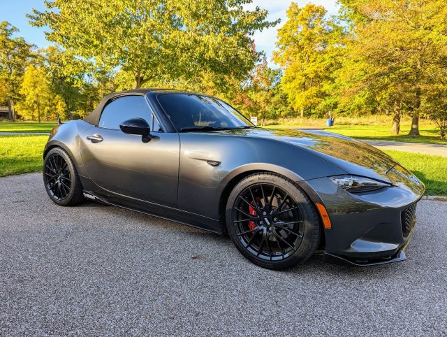

Decided to pick this up this week. 2021 ND2 miata, club spec with BBS+Recaro package. Tasteful mods (coilovers, catback, short shift kit) and a really good price. Excited! I got a little tired of waiting on my GR86 to come in (oh and the current crop of RTV + engine detonation issues worried me). Decided to go after the ND2 after autocrossing a few in recent weeks. Just fell in love with the car.
Plan for this is to convert to C-Street use in autocross for 2023 season and sell the FRS once it is repaired (someone hit me 3 weeks ago in that car!)
Fiesta isn't going anywhere :)

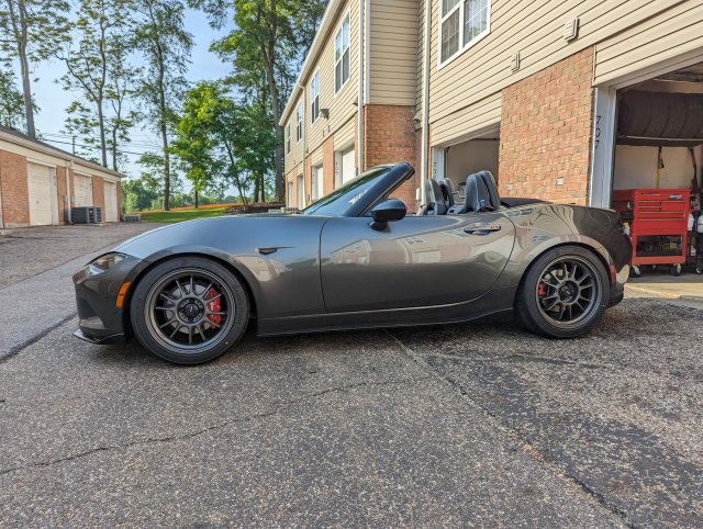

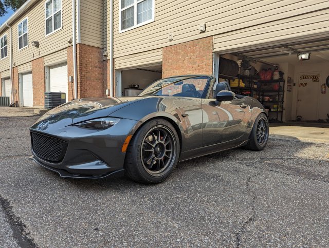

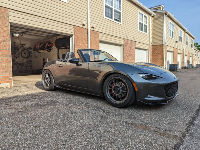

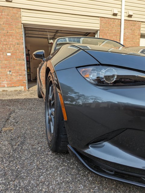

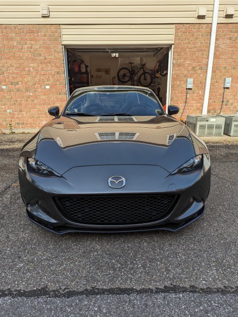

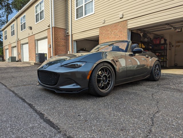

Thought I'd update this thread. Since I have another autocross car (SSC Scion FRS), I decided to do an STR "lite" build on my Miata.

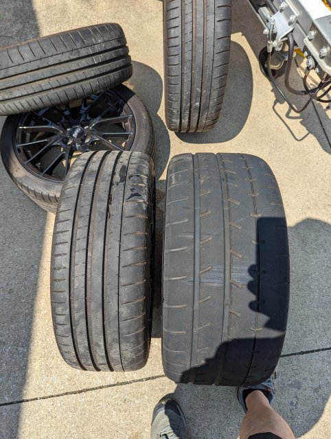

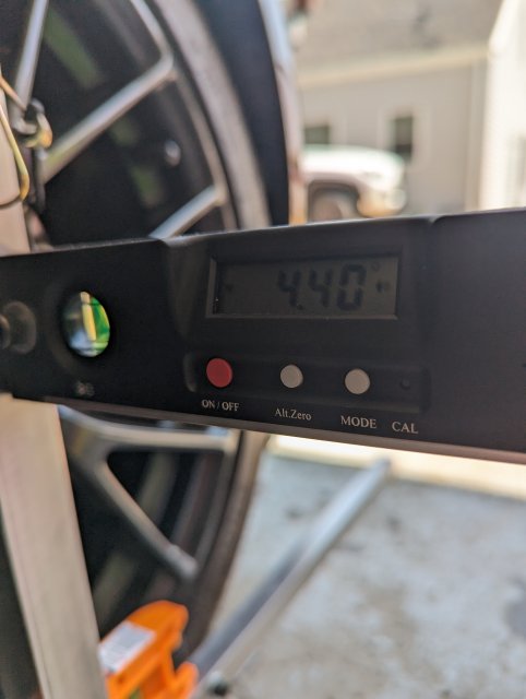

Setup is 1WNR MCS with revised Karcept spec valving, 650/300 springs, front and rear karcept sway (.250 bar up front). Offset bushings and 17x9 wheels with 245-40-17 RE71RS
Initial driving impressions are very good. It rides SOO well on the street. I can see why people love the MCS. They are very pricey but worth it.
It's sitting a little low as is (about 12.5" all around), so it isn't ready for events quite yet. Rubbing fender liners pretty bad near full lock.
In a couple of weeks we are going to raise ride height (targeting 12.7" front 13.0" rear), corner weight the car and tweak the alignment (-4.0 up front, -2.5 rear, 0 toe front, 1/16" toe in rear). Then should be good to go
