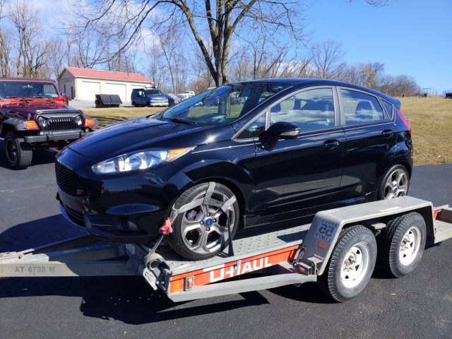

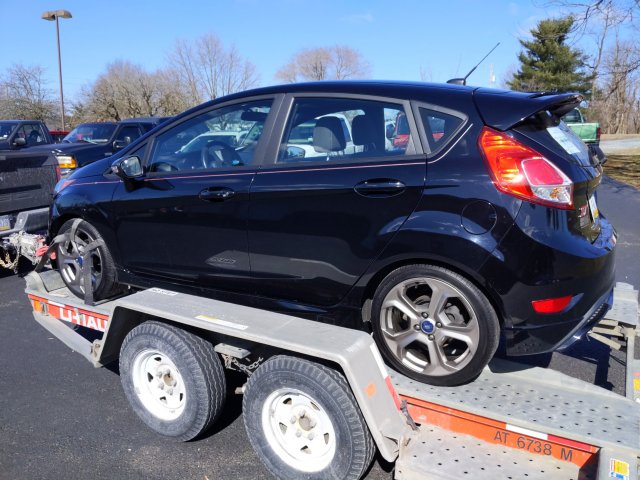

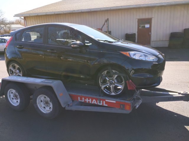

Here's some photos, some were taken with the old SES when the new owner purchased it.
