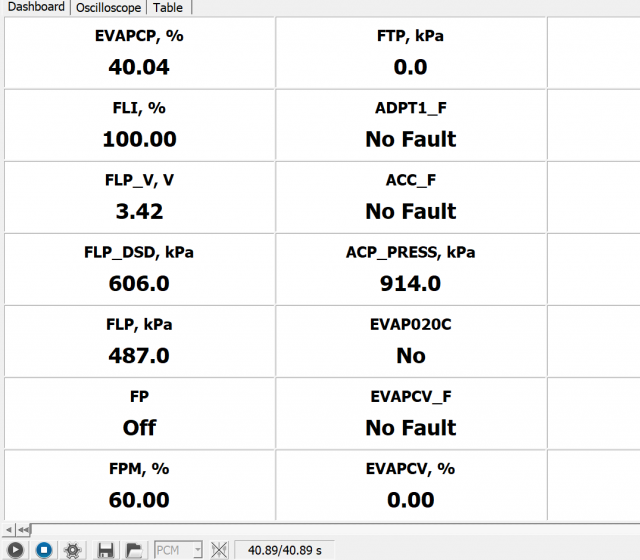

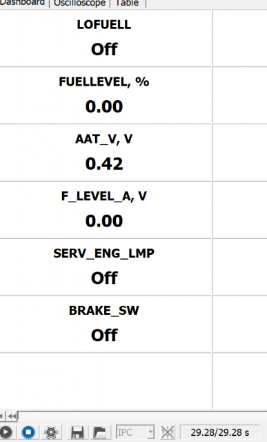

ran forscan tests on IPC (ipc_forscan_capture.png) and PCM(capture.png) modules. FLI (in tank level) is detected as 100% and IPC senses 0%. Does PCM know fuel level before IPC? or through IPC. Any ford gurus on the forum pls help!!

No cel but Fuel guage still stuck around 3/4. Fuellevel parameter in ipc is 200% !!!. Ipc is the prime suspect but will double check fuel level sender resistance (180ohm e-10ohm f) . Suspect ipc has a glitch. Loaded factory config thru forscan but no improvement. Got a salvage ipc ( matching part number and lesser mileage) . Any links for programming (should connect new ipc while car running and loaf as built) the ipc or is it plug and play?
