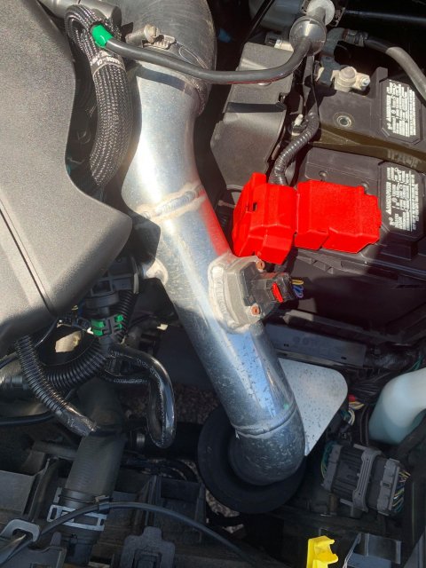

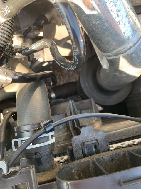

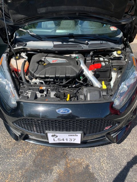

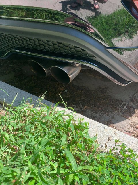

Hello from northern VA. Just bought a black 2016 Fiesta ST with 32K miles last weekend and love it so far. The previous owner put an an aftermarket intake and exhaust on it and i havent been able to identify either of them (havent got under the car to see if the muffler has a brand on it). The car is pretty loud both spooling sound as well as exhaust which i dont mind, just want to know what is on the car. i attached a couple pics in case someone can identify. 119415107_1021010928325269_2996386614924967526_n.jpg 119237996_353335086026516_974851372288867790_n.jpg 119552049_321964952217207_5801901493922852809_n.jpg 119229692_321774039046546_3814033567113994089_n.jpg

I don't recognize the intake or the exhaust, but someone probably can.
Looks like a little cleaning under the hood wouldn't hurt.

I'd lay bets on both the intake and exhaust being custom fab work. I don't know of any intakes the reuse the OEM plastic evap line connections. Looks like none of the OEM intake is left, so you'd need a full intake to replace it (hopefully the OEM bend at the turbo is still there). For 16+ that just leaves Mishimoto (good sound, works without CEL, has fitment issues), Whoosh (full kit is kind of spendy, I have no experience with it), or cp-e (also no experience). If you buy a 14-15 evap line, there are some other options as well like Injen's. Cobb's requires the factory lower airbox.
Not that any of this is necessary; most tuners have found no performance advantage to intakes before you go big turbo. Mostly they're just for sound. But getting a full OEM intake would be spendy, unless you can find someone here that has one they would let go of for cheap.
