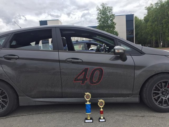

I run 15x8 Pro Races, and have used both the Rivals and RT660s in 225/45R15 with both Swift springs and moderate/low settings on Fortune Auto 500s. I got just a hint of rub when I hit a big bump at full lock autocrossing. I actually think the slightly smaller diameter is a plus, because you get some lowering of the cg without compromising your suspension geometry. They also tend to be lighter and cheaper setups. The difference in gearing is minimal.

RT 660, hands down. The Rival is ok if you can get heat in them, but we have really small parking lots and lower ambient temps, so they were frustrating. RT660s warm up even faster than REs, provide comparable grip, and come in the perfect size (which the REs don't. I had some weird wear on the center rib, but it kind of evened out.
Some people don't like the look of 15s, but I kinda like the small diameter/chonky tire thing. Aesthetics aren't my primary concern.
