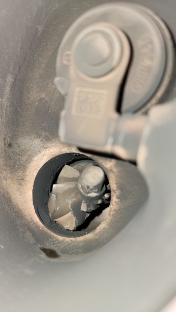

Late to the party …. but did you say you checked the wastegate solenoid, it’s wiring, and the tubing?
Yes, the wastegate starts closed as it should. Tubing is fine, since it's brand new as well as the solenoid. There is not any air pressure going into the solenoid to open the wastegate at all. I suspect that air pressure comes from the compressor, and well since the compressor isn't spinning it would make sense that no air is sent there.

So ya, turbine is toast.
Definitely sucks, but I can't complain to much with how much I've put this car through. I'm tempted to get an upgraded hybrid turbo, but for the extra cost I'm not sure it's worth it, Ford sells the stock turbo for 800. I think the cheapest hybrid is 1400 on Whoosh. Definitely open to ideas, but I don't track the car anymore since it's the daily now and just leave all seasons on for the cold. So more power would be fun, but would definitely spin the tires more.
Just some notes, it has been very, very hot here. I park in an underground garage, so I start the car in cooler Temps, then drive it into much hotter Temps. So maybe combined with age, heat and the way I've driven the car I imagine the blades just stress cracked and gave in. The compressor spins, but the turbine doesn't, so I wonder if the shaft snapped in half.
Another thing, the BPV was definitely getting stuck, when I replaced it, I heard the BPV making noise where as previously it was not. I almost wonder if it got stuck, and maybe somehow overspun the turbo? But just a guess, I thought the BPV blew off intake air into the compressor.
Glad I found it, and nothing else appears to be damaged.

That’s definitely shot!
You could also see if anyone on the forum has a low miles turbo that they’d let go for cheap.

Wow! That worth displaying on your book shelf! I made one of my failed turbo's an ash tray, not that I smoke. Lol. Shaft definitely snapped then turbine contacted the housing or turbine contacted the housing and then the shaft snapped. Good thing it was the turbine and not the compressor which could've sent shrapnel into the motor
